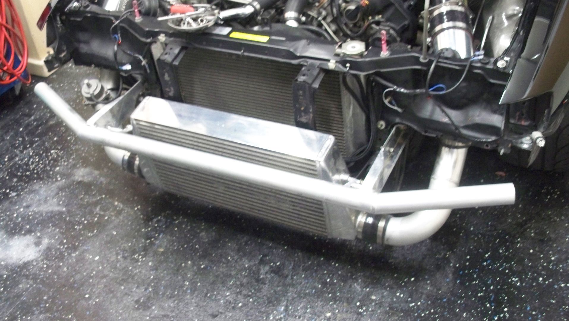

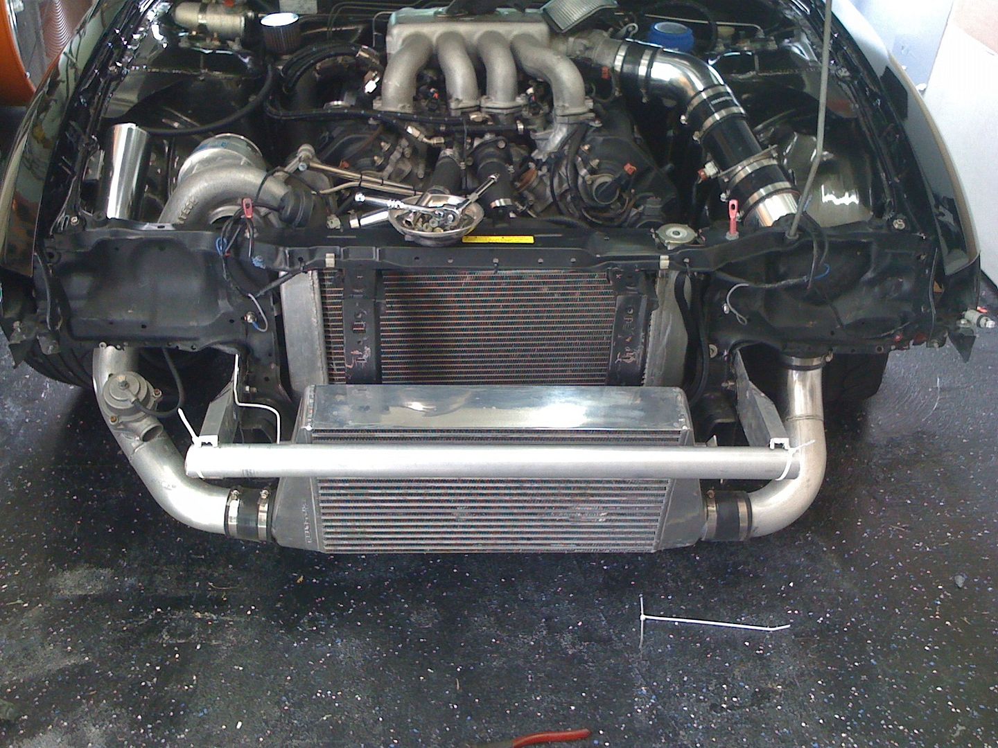

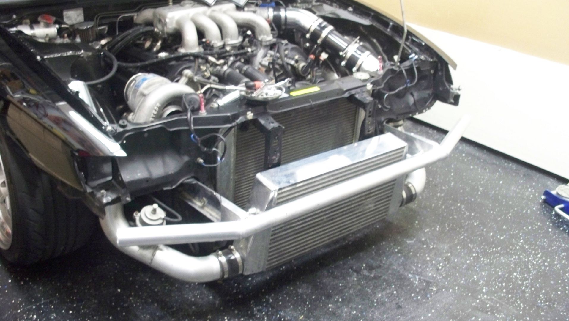

So now that i got the tig I started my first aluminum tig project...
Been wanting to do this a long time
Aluminum crash bar.

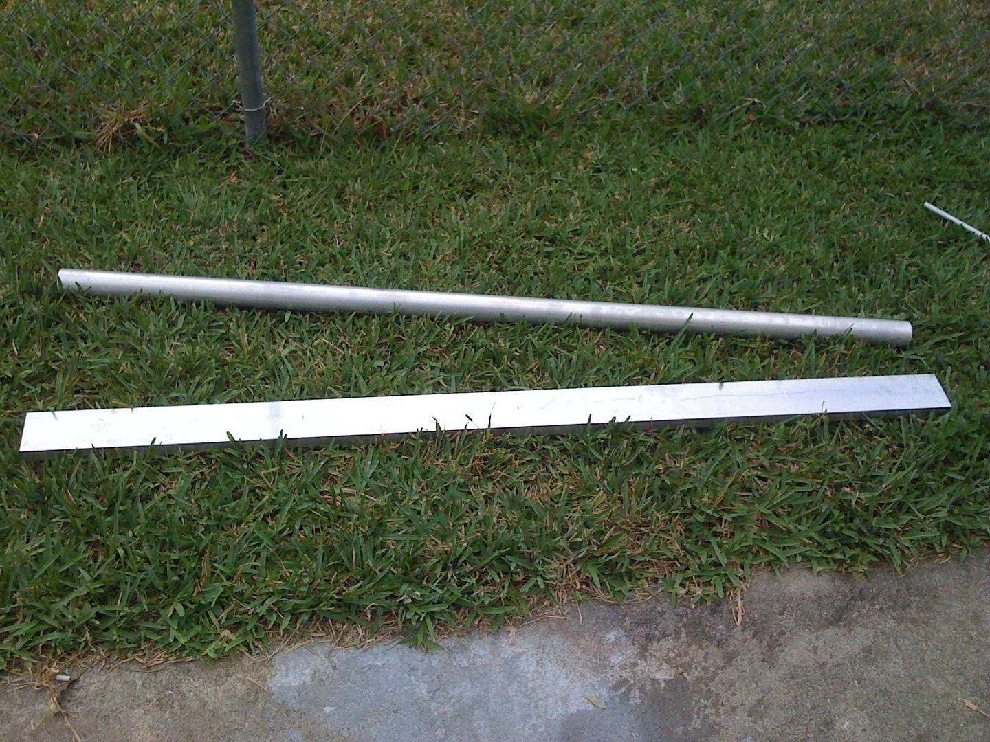

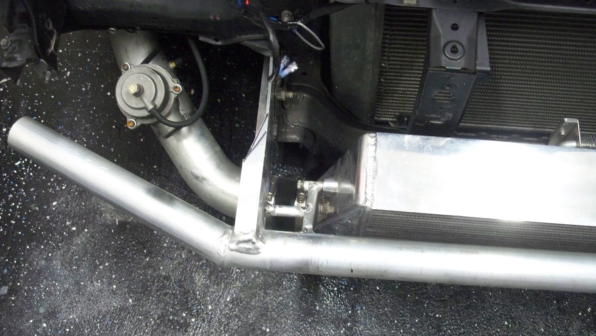

Started with this 1X3 rec tube, and 2 inch sch 10 aluminum pipe
Brakcets and such
Since i dont have a bender.. yet... i had to weld the angles on the end
Also incorporated intercooler mounts...
and its done, its plenty sturdy, i stood on top of the welded ends and jumped up and down on them a whole bunch of times and they didnt break lol so thats a good sign i guess.
yes i do this for fun lol, not work, and its my first time tigging aluminumn, they where shiny and such the way they where supposed to look but i brushed everything.

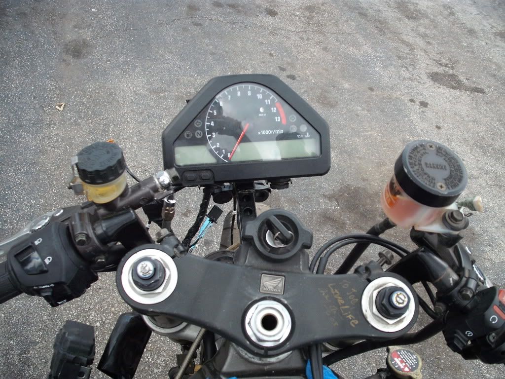

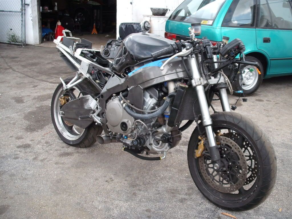

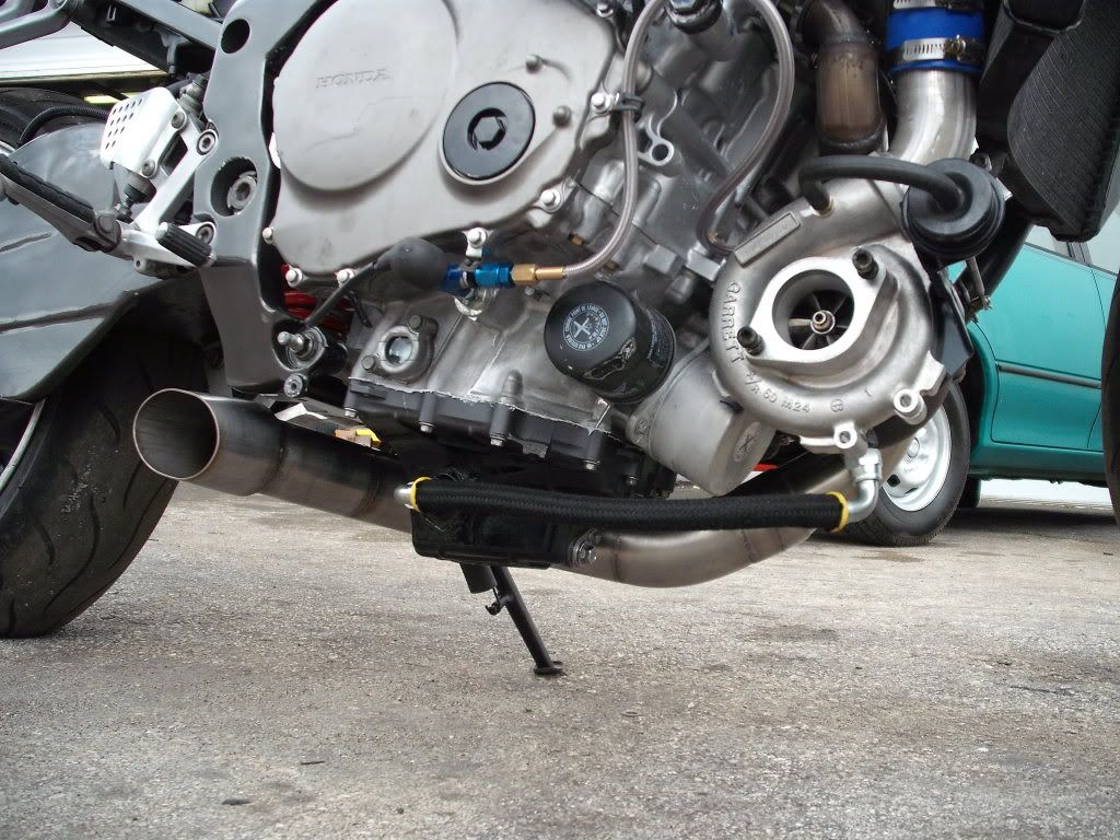

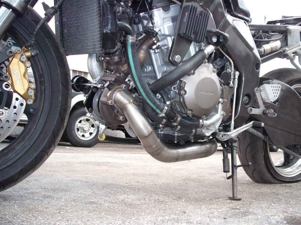

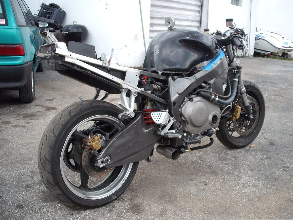

some new pics of my bike project 98 900rr with 05 1000rr motor swap and turbo got her running today
