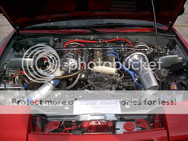

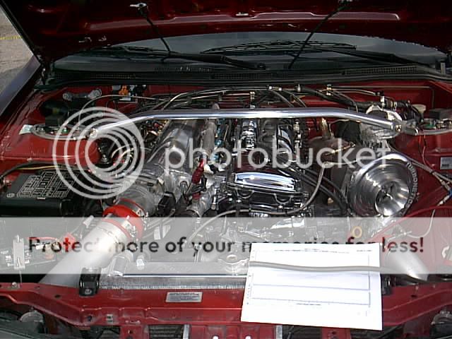

I dunno but 400hp on a ka-t is nothing compared with what the rastas in miami have...
I dont know if you guys remember these cars but they were in the ter tech event in hialeah in december of 04.
but those guys were easily running 500hp+
well they were a bit higher, one motor was about 500hp and the other one was about 100hp+ more. I didnt take a close up of the dyno sheets, and I wish thats how the girls in ct. looked. If they did I would be married by now.
