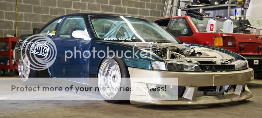

And Dj, when he posted those pics, I stared for like 15 minutes, no lie. 17x10 -18 and 17x11 -1!! mnmmm
