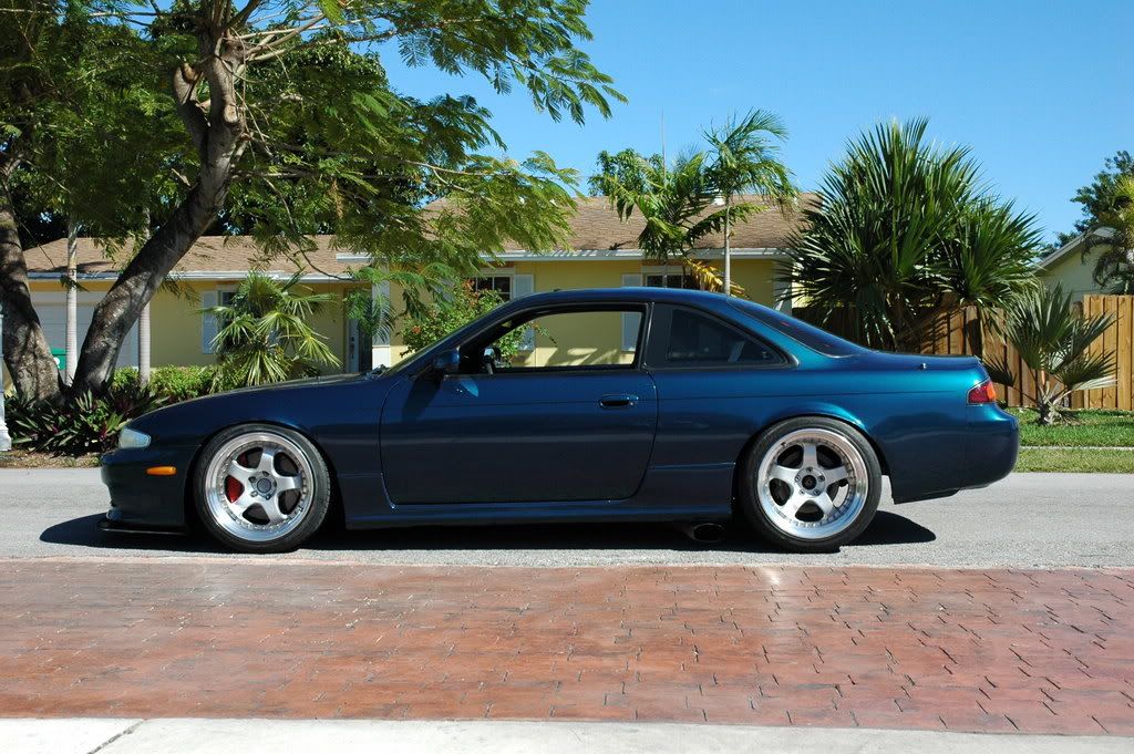

Yes those are evo brembos up front, stock brakes out back. Bites hard and has already saved me a number of times from crashing.
front 17x10.5 +20 with a 25mm spacer so -5 camber is -3.5
rear 17.10.5 +20 camber is -1.5
i wanna get spacers for the rear possibly a 25mm spacer n i wanna get a smaller side wall for the front n go lower!

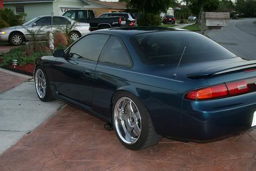

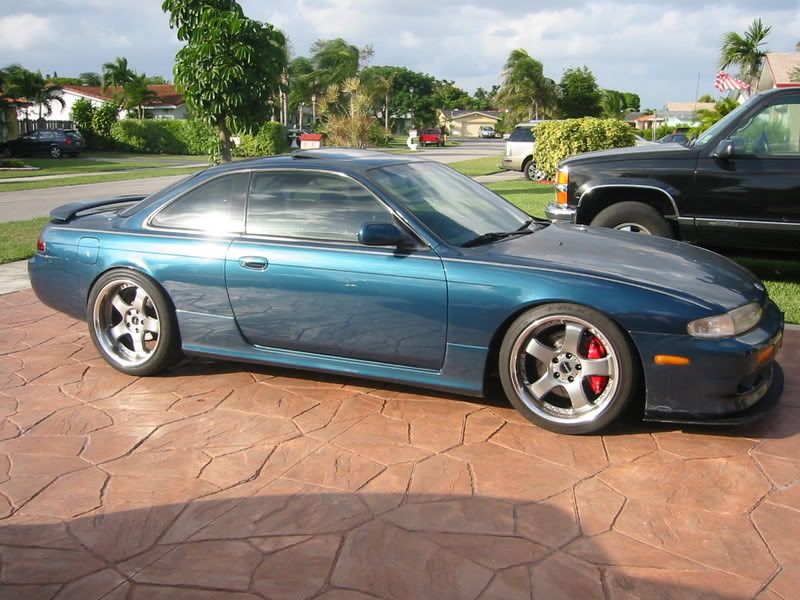

Ive had and fitted a few different setups so ill post specs for each, these are the most basic ones, i want post the 20's lol

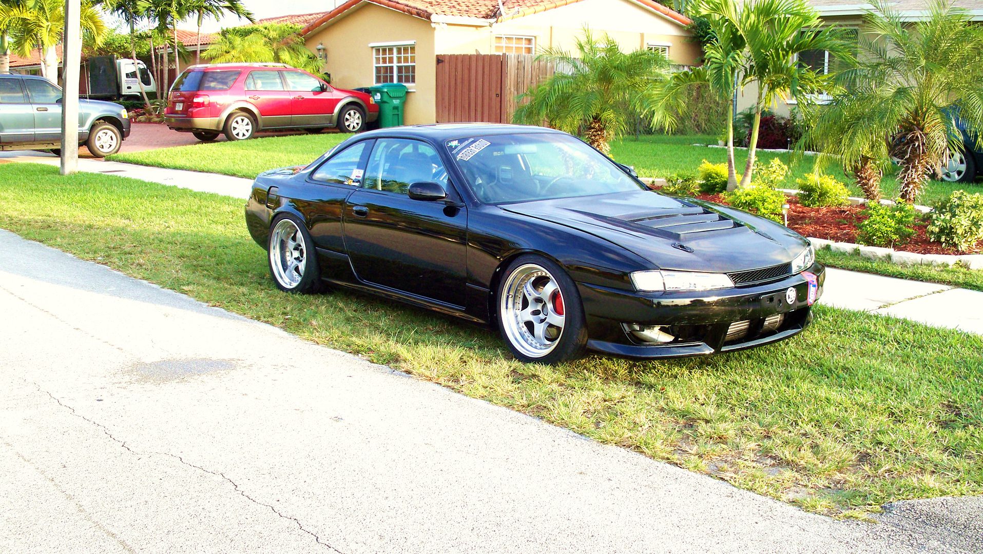

1. S13/S14/S15 = s14
2. Suspension Setup/Brands = tein super drift
3. Wheel/Rim Size front & back = F 18 by 9 R 18 by 10
4. Brand of Wheel/Rim = work termist ts2
5. Offset front & back = F +15 R +20
6. Spacer Size = none
7. Tire Size/Brand front & back = Falken azenis rt 615 235 / 255
8. Alignment Specs = zero toe 2 degrees fr 1 degree Rr
9. Clear Zbrakes & what size brakes = z brakes and brembos
10. Fender Modifications: rolled/pulled = F roll R roll
11. Picture.. from the side & down the side =
12. Over Fenders Brand & mm Size = none
13. Tire Pressure front & rear Track/Daily Driving =

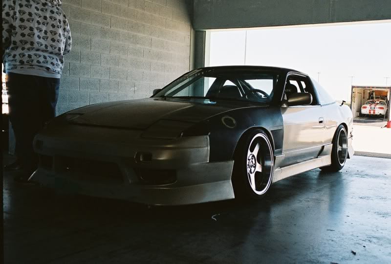

Front:
30mm overs
18x8.5 -5
Nexen N3000 235/40/18
Rear:
50mm overs
18x9.5 -15
Nexen N3000 265/35/18
XXR 502s
Extreme Dimensions Type U Kit and Overfenders
yea front ventless. they have the vent style too, but i like it without and it gives a less rice feel... i think the taillights says "rice" enough on their own lmao. we also did almost ZERO mods to the kit to install it, everything fit pretty damn awesome.
i have one pic from the front, but its missing front kit still... i exploded it so had to order a new one :(.... so its fugly. ill post it anyways i guess...
oh and there are spacers, but yea the offset i put takes that into consideration...
edit* for pic and the sunlight + iphone camera make the yellow look ugly in this shot ><
Oh and btw the gap to hood is from my radiator cap touching, not the fenders being wrong. My mishimotor universal racing crazy radiator needs to be remounted lower.
your crazy, those tails are WAY better than the stock american ones, Ive driven a 240 since 2001 so I'm really sick of the stock look, I cannot affor the 400$+ koukis, and these came on the chassis I got, so why not rock them.
and I thought about 9.5 all around but I have steering clearance issues with the diameter of the 18s and the tires when at full lock with the knuckle mods I have.
It doesnt hit the fender, it hits the tension control arm, which I cannot dent/move so i have to avoid it. If I got the wider wheels, the offset is the same, meaning I have more inner width that will come into contact even sooner. If I was on 17s, I'd have done it in a heartbeat.

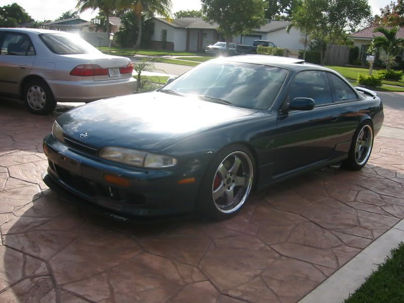

Front: 17x9.5 +12 w/ 215/45/17 (camber maxed) pull (no spacers)
Rear: 17x9.5 +12 w/ 215/45/17 (camber maxed) (I need 10mm spacers)
Rota Grids in Hyper Black
http://i607.photobucket.com/albums/tt157/leomiami14/100_0725.jpg
http://i607.photobucket.com/albums/tt157/leomiami14/100_0724.jpg
there is no reason why you should be running that much camber out back, your wheels only sit 3mm more inward than mine.
