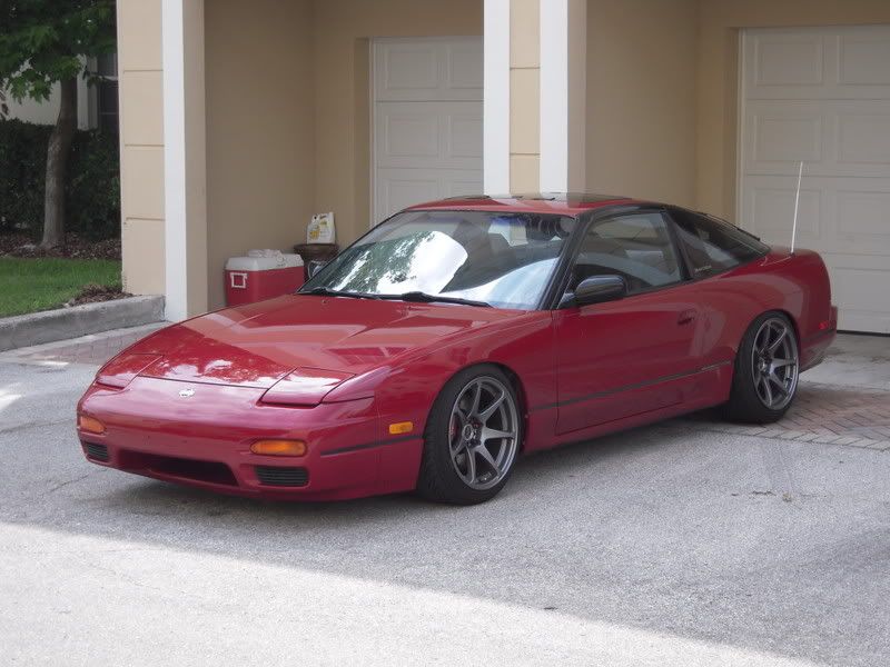

Front: 17x9.5 +12 w/ 215/45/17 (camber maxed) pull (no spacers)
Rear: 17x9.5 +12 w/ 215/45/17 (camber maxed) (I need 10mm spacers)
Rota Grids in Hyper Black

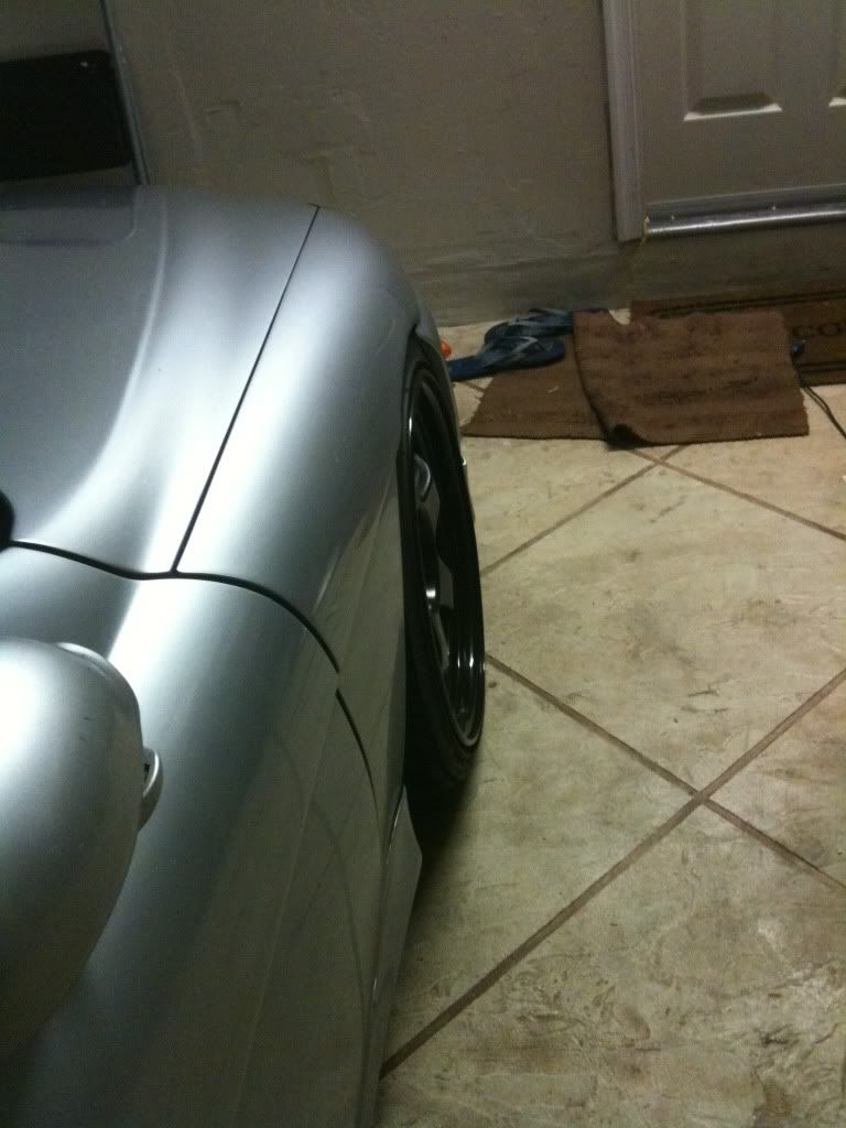

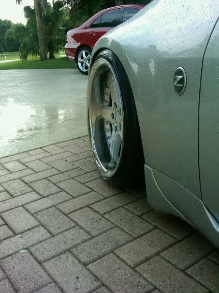

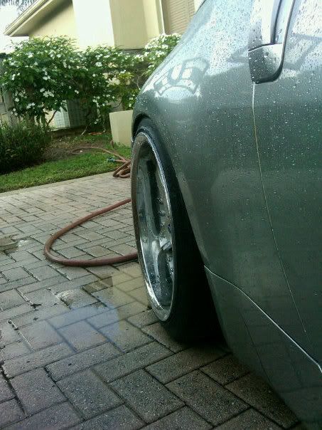

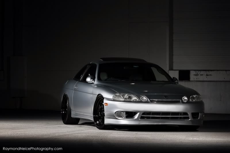

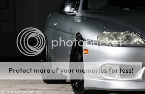

Front: 19x9.5 +14 w/ 10mm spacer R-Disk 245/35 (-3 camber) rolled fenders
Rear: 19x10.5 +23 O-Disk 275/35 (-3 camber) shaved, rolled, and slight pull
Work Meister S1 3-piece Matte black face with gloss black lip.
Suspension: Stance GR+ Pro coilovers
Before 10mm spacers up front:
After spacers (only pic I have so far)

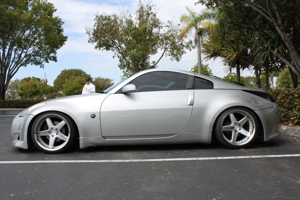

I just wanna post a pic of my car.

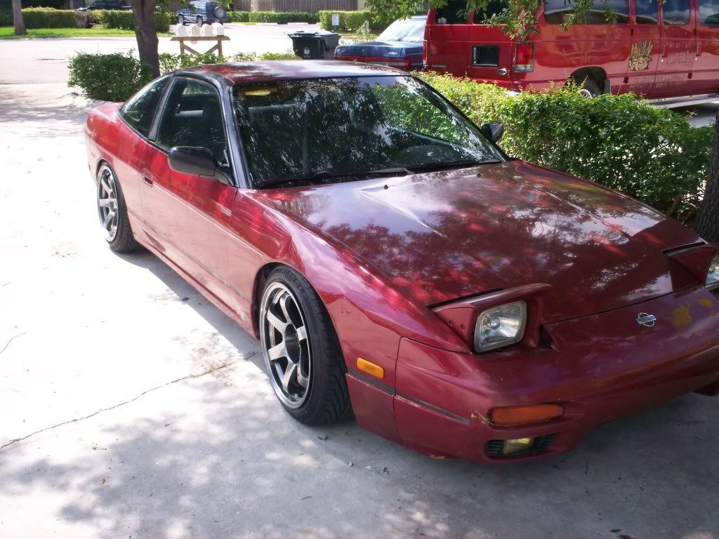

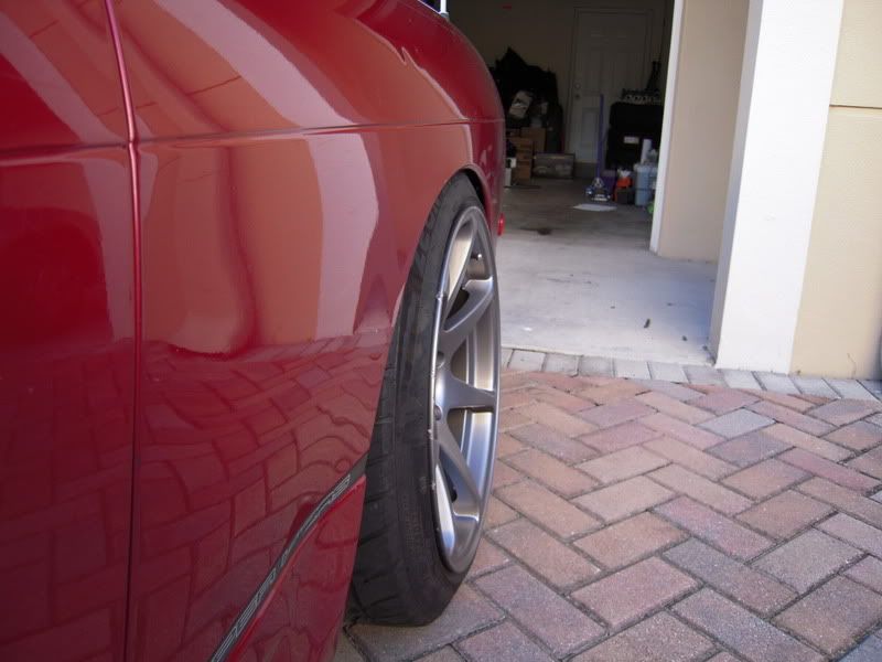

17x9 -3 front with 20mm fenders -3.something camber
18x9.5 -8 rear with 30mm fenders -1.5 camber
let me see if i did this right...
rota grids
17x9+12 front (205/40/17)
17x9+12 rear with 2mm spacer (205/40/17)

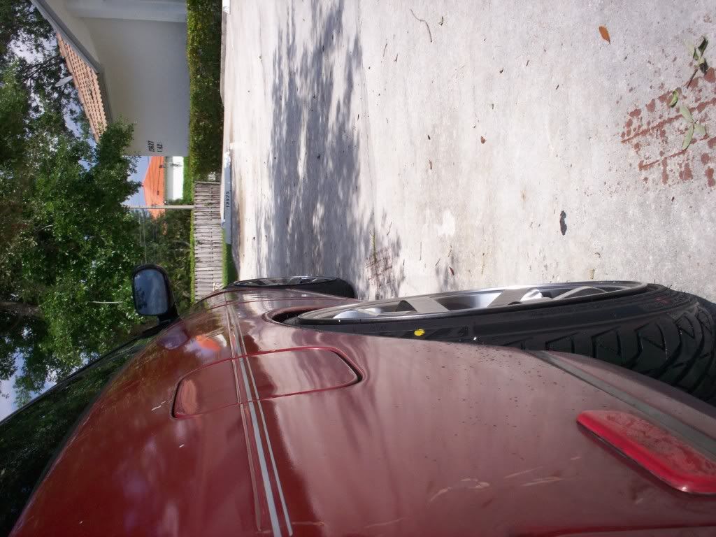

Front: 17x9.5 +15 w/ 215/45 Feddys, 2 degrees of camber
Rear: 17x9.5 +15 w/ 215/45 crappy coopers, unknown camber but more than front from the looks of it
Fenders: Rolled
Inner wells: Front bashed in but still rubs a litte in full lock
