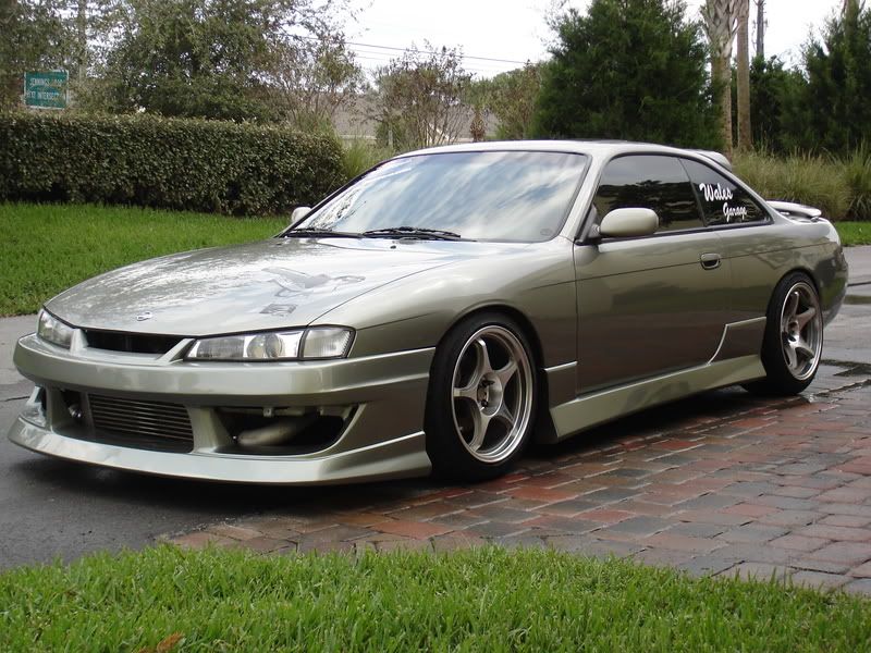

Now I know this is an s14 and they have more room, but look how much better this looks.
Just sayin xD

this is my coupe on 8 fronts w/ spacers 9 rears with no spacers. I had 9s all around, but smashed 2 in a wreck.
