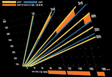

well the 6spd is different as far as ratios, heres a graph
anyways, this link might help you out a bit

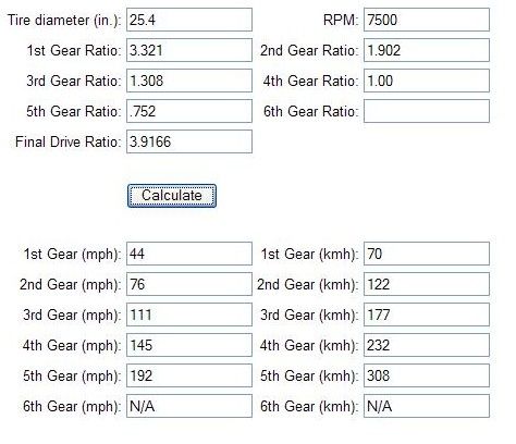

on the v8 car i run a z32 n/a tranny. this is the gearing speed graph i made a while back
It is correct in real life ...
