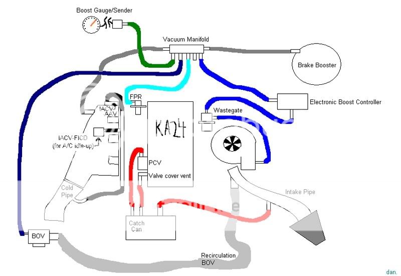

thanks guys learned alot past 2 days here much appreciated, ive heard about the maf being to close being a problem should definitely try that. as for the fuel pump its my second walbro because I thought I had issues with the first one. js I had it up to 41-43 and it back fired alot so i lowered it, when I gave it gas the gauge needle just wiggles alot... which is now making me think theres a big vac/boost leak? I searched this diagram up and im gonna route my bov, FPR, and wastegate like this.
EDIT: also would I have to connect my FPR to the brakebooster or could I just leave it connected to the stock vacuum line connection?
my catch can only has two ports and that looks more like an option any way so im gonna pass on that part lol
EDIT: only thing is since theres two vacuum lines on the wastegate how do I know which one ends to the brakebooster? does it even matter?
no stock vacuum port there.. its all gone.. lol
EDIT: and the side one? what lol if your facing the engine bay on the waste gate one is on the right and one is on the left of it

hmmm basically I cant hold vac when I hav the bov and wastegate connected to it so im gonna try the bov by itself and go from there.
.... frustrating... I cant connect anything to the brakebooster, if I do when I finally do get it on, it turns on for alittle maybe 15-20 seconds and shuts off.. must be a vacuum leak? cannot find the dam thing... shit!
honestly i wouldnt use the booster for vac source for the block
try another source of vac...for the block
u should run wastegate on turbo side...
fpr by itself...
and bov u can t off for gauge
