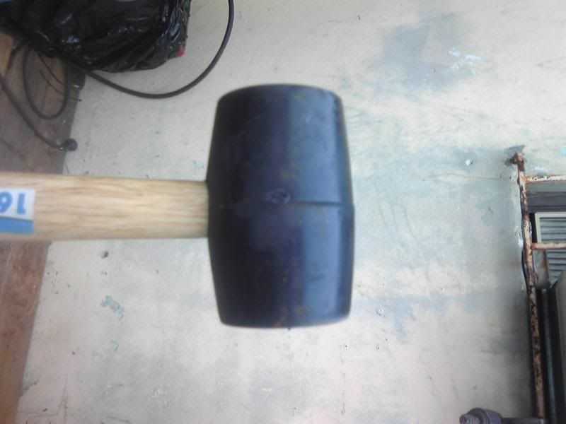

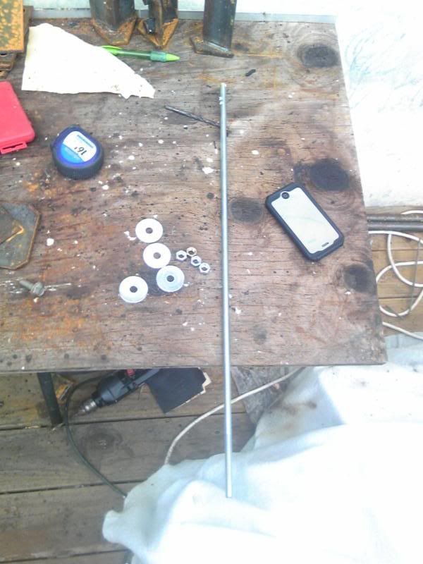

Materials Needed:
1 - Tube of super glue
2 - 16oz Rubber Mallets
![IMG00025-1.jpg](/proxy.php?image=http%3A%2F%2Fi18.photobucket.com%2Falbums%2Fb105%2FThe1udreamtabout%2FIMG00025-1.jpg&hash=ee086d5679b2169c604338e2c910d9ff)

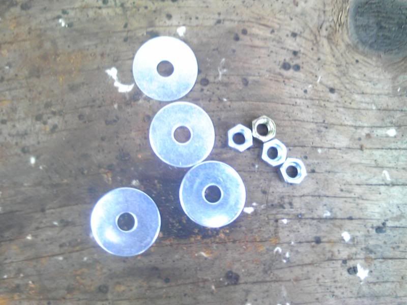

1 - 2ft length of 3/8ths all thread
4 - 3/8ths Nuts
8 - Washers (only 4 pictured)
![IMG00023.jpg](/proxy.php?image=http%3A%2F%2Fi18.photobucket.com%2Falbums%2Fb105%2FThe1udreamtabout%2FIMG00023.jpg&hash=fd562781e164d2934d63230b515fd683)
![IMG00022-1.jpg](/proxy.php?image=http%3A%2F%2Fi18.photobucket.com%2Falbums%2Fb105%2FThe1udreamtabout%2FIMG00022-1.jpg&hash=563fe29b4e0e4d9d94c7adcb8717fd4c)

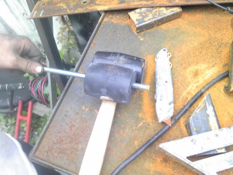

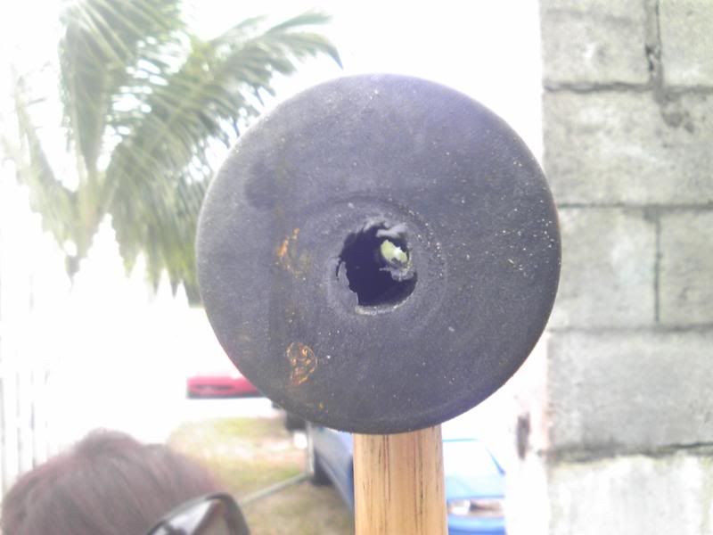

Step 1
Take your drill and drill a hole straight through the rubber mallet width-wise.
(there's metal in the middle so make sure you have the proper bit)
![IMG00026-1.jpg](/proxy.php?image=http%3A%2F%2Fi18.photobucket.com%2Falbums%2Fb105%2FThe1udreamtabout%2FIMG00026-1.jpg&hash=3129d5d2edc41291dad8deb42b336dc2)

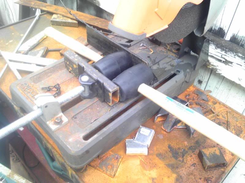

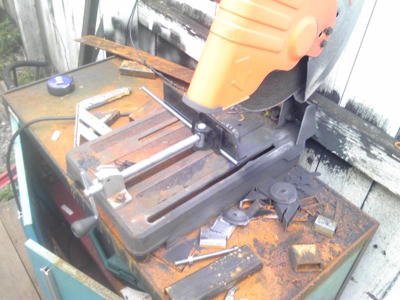

Step 2
Then Cut the handles off
![IMG00021-1.jpg](/proxy.php?image=http%3A%2F%2Fi18.photobucket.com%2Falbums%2Fb105%2FThe1udreamtabout%2FIMG00021-1.jpg&hash=391570c8b0ae6f80b6f612a05f969f6f)
So they look like this
![IMG00027-1.jpg](/proxy.php?image=http%3A%2F%2Fi18.photobucket.com%2Falbums%2Fb105%2FThe1udreamtabout%2FIMG00027-1.jpg&hash=cde90a3409cb3f230de8a7fd8a238cbb)

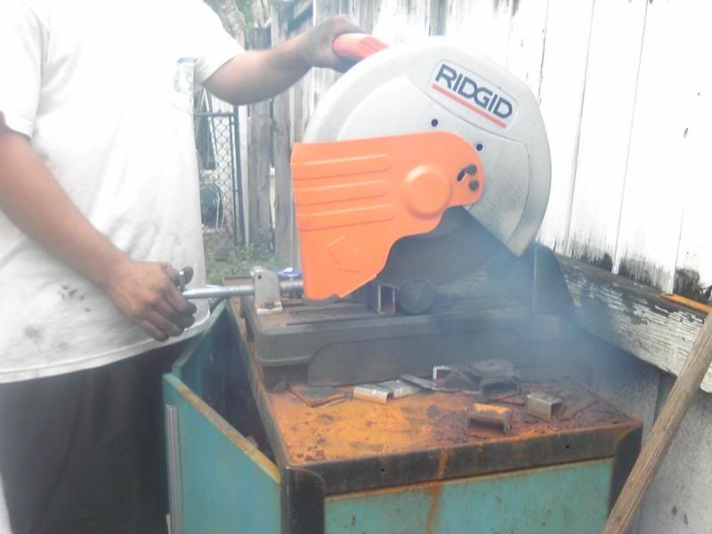

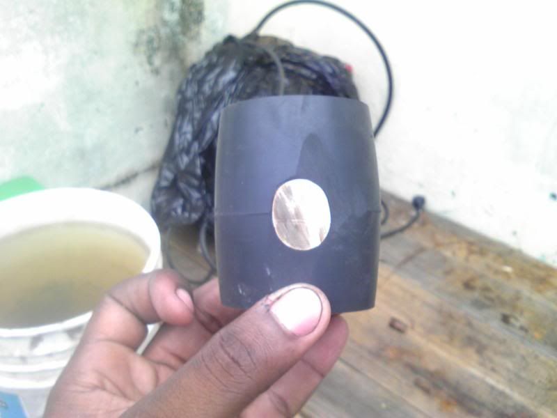

Step 3
measure the rubber and cut off rubber it until it measures 3 inches
(you can go smaller to lower the motor if you have clearence issues)
![IMG00028-1.jpg](/proxy.php?image=http%3A%2F%2Fi18.photobucket.com%2Falbums%2Fb105%2FThe1udreamtabout%2FIMG00028-1.jpg&hash=96229dbe386c9a836fb9cd21ca27cf77)
like so

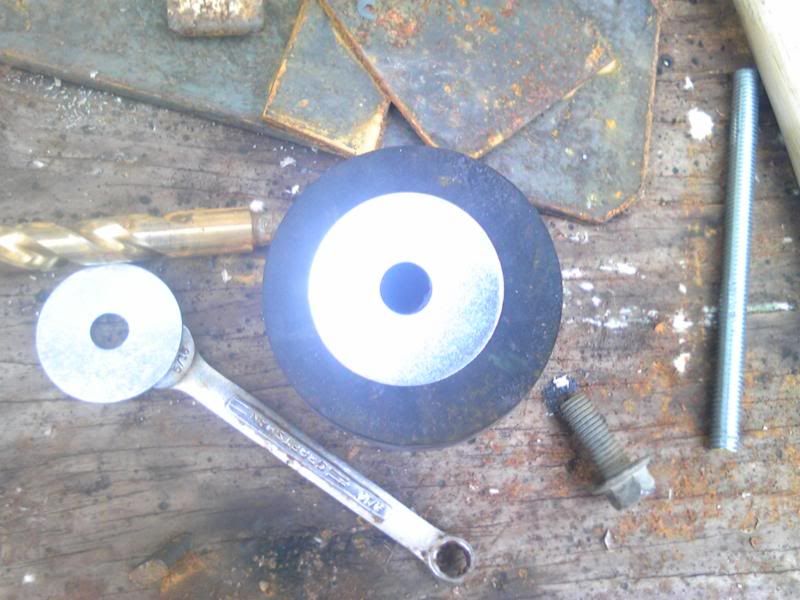

Step 5
Super Glue your washers around the holes on the rubber
![IMG00030-1.jpg](/proxy.php?image=http%3A%2F%2Fi18.photobucket.com%2Falbums%2Fb105%2FThe1udreamtabout%2FIMG00030-1.jpg&hash=b3b2260b9e17d7db8fe7648f4e932437)

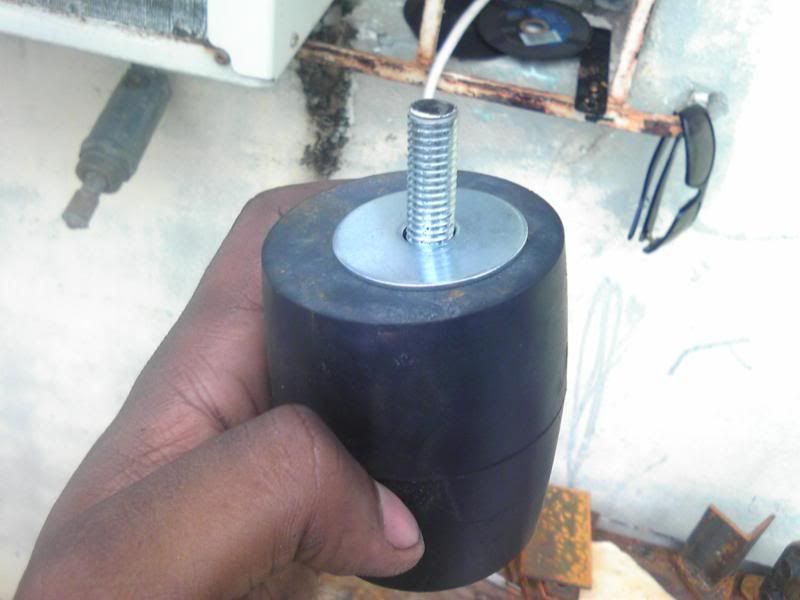

Step 6
Push your 5&1/4inch lengths of all thread through the rubber
![IMG00031-2.jpg](/proxy.php?image=http%3A%2F%2Fi18.photobucket.com%2Falbums%2Fb105%2FThe1udreamtabout%2FIMG00031-2.jpg&hash=ee678c125e00533106509968d17034a3)

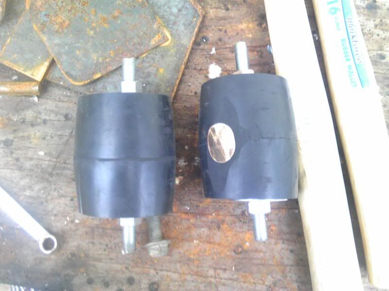

Final Product
![IMG00032-1.jpg](/proxy.php?image=http%3A%2F%2Fi18.photobucket.com%2Falbums%2Fb105%2FThe1udreamtabout%2FIMG00032-1.jpg&hash=f8528b9b7abd87963809f53d2d4afd62)
i chose to leave them bare, you can also wrap them in heavy duty tape or what not.
