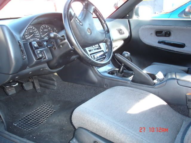

Don't forget the bolts you can't use auto tranny bolts but u can use the auto starter and as for the pedal just cut the brake it will still fit without it cut but its funky to drive
you have to know were to cut it the auto pedal is EXACTLY THE SAME SIZE FROM THE MIDDLE TO THE RIGHT but obviously bigger from the middle to the left just do like i do get the rubber grommet off of a manual 240 use it as a template snugging in on the right side and marking were to cut from the left side then put the grommet on and nobody will know the difference :bigthumbu
o and i got a 5 spd cross member and stock shifter for sale if your interested :bigthumbu
o yeah and like he said the auto starter will work
now u tell me this is that a stock pedal or a cut pedal???
