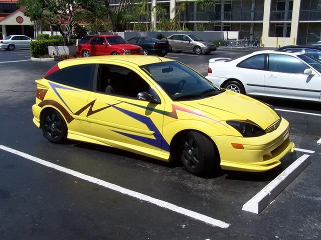

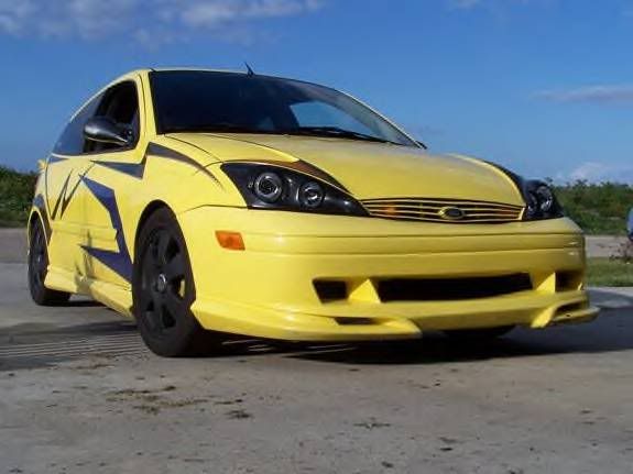

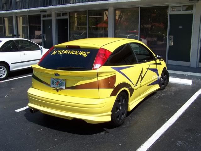

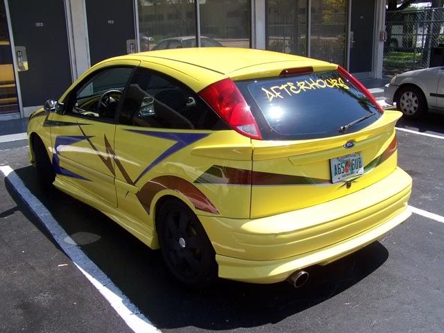

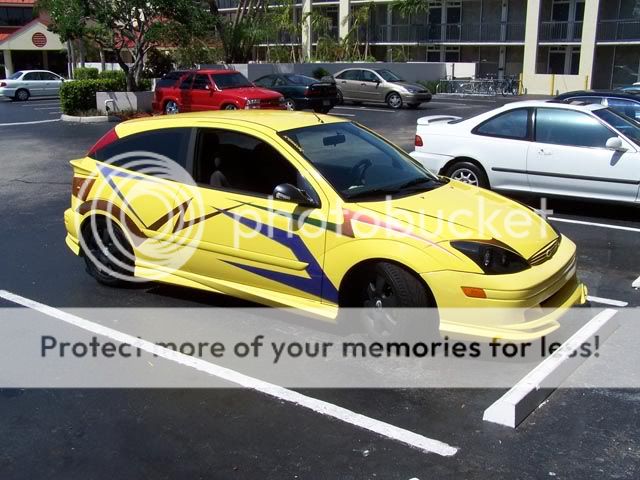

i dont paint any more i had to stop due to heath problems. I use to spray with out a resperator and now my lungs are horribly fucked up. lol i know i should where one but they are hot as hell. lol I toss up some pics of my brohters mustang it was the last car i painted.
heres my old focus i painted for a girl in plantation then i bought the car off her about year after. Took me two weeks all the graphics are HOK kolor shift paint.
you reatard... you should have worn the resporator... well cant you just wear it now and still paint? good i love the smell of paint though when its being sprayed... smells sweet.
