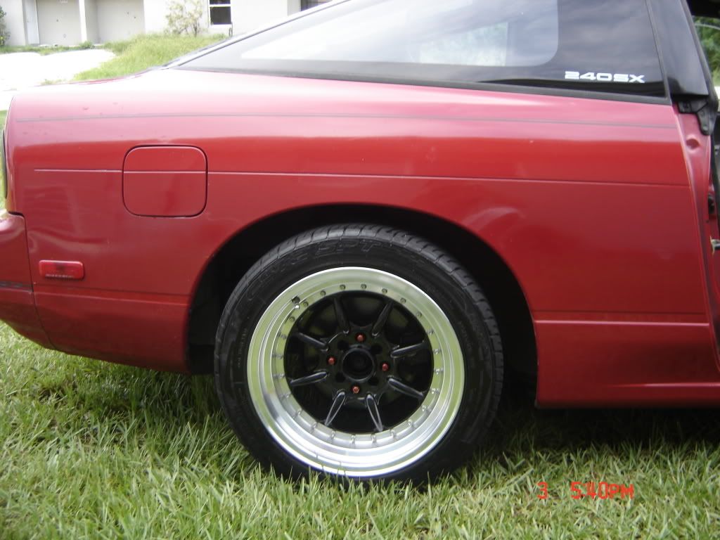

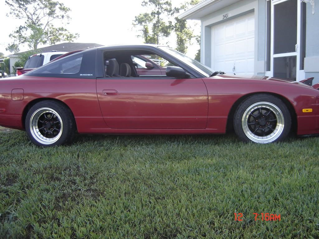

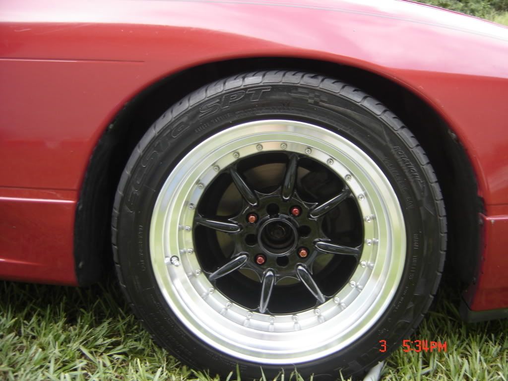

dude i have sportmax 002's 16x8 0 offset with 45 profile tires in it fits perfect and i have it pretty low, my fenders are not rolled an it never rubs unless i hit a pretty big bump. if u want it to never rub no matter what u hit just tap the inside of the fenders in a lil with a hammer so that metal lip dont stick out an ur golden it wont hurt your car i promise, lol
trust me it will work i have proof cuz thats what i have

tires are 225/45/16, i got tien flex coilovers and it still can go lower if i want but the way i have my motor mounts on my rb the oilpan it way to low so i cant go any lower cuz of that, not the rims. i already ate a hole im one oilpan
