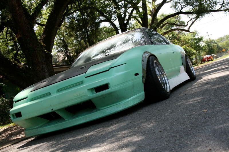

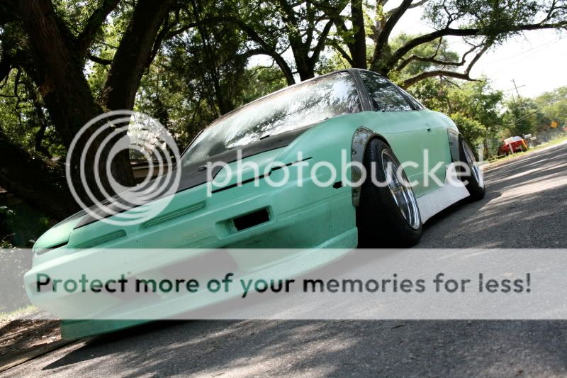

his inital tune netted just about 200whp with no cams, stock compression, a header, and a tune with itbs. thats what im aiming for. ill have a lil bigger injectors tho and ill be running two 91-93 exhasut cams for a little better duration...should be done any day now guys. heres a teaser pic:
