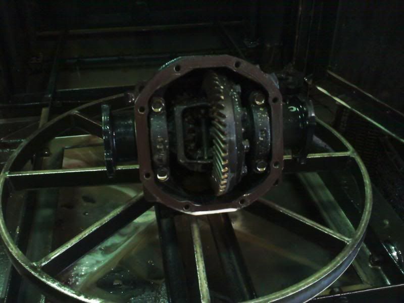

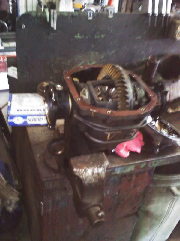

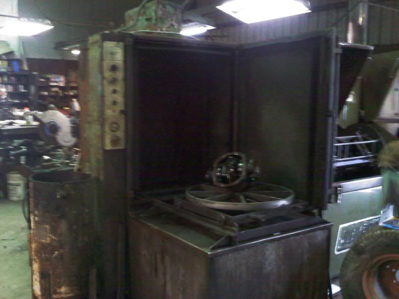

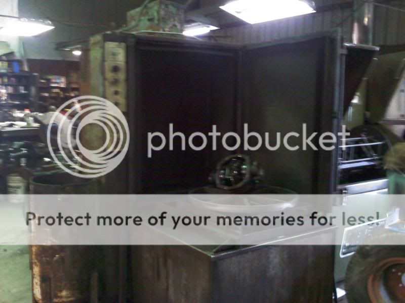

Step 1. Clean your Diff. let it drain completely, if you're in your garage, use brake parts cleaner (the kind that doubles as a flame throwing spider killer), and thoroughly clean the spider gears, and as much of the inner housing as possible. as shown, it's in a parts washer.
Clean on the inside clean on the outside, clean on the inside clean on the....
finish it up with brake parts cleaner (make sure to hit both sides thoroughly)

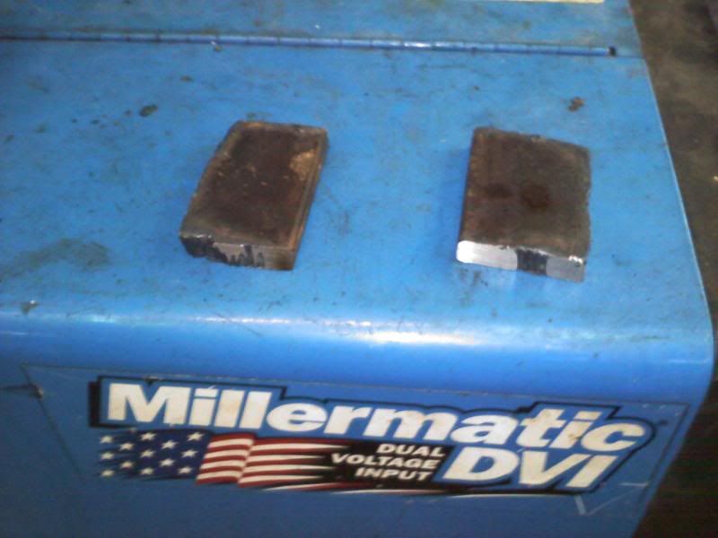

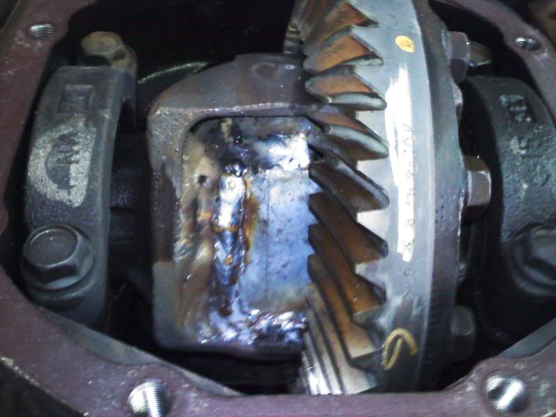

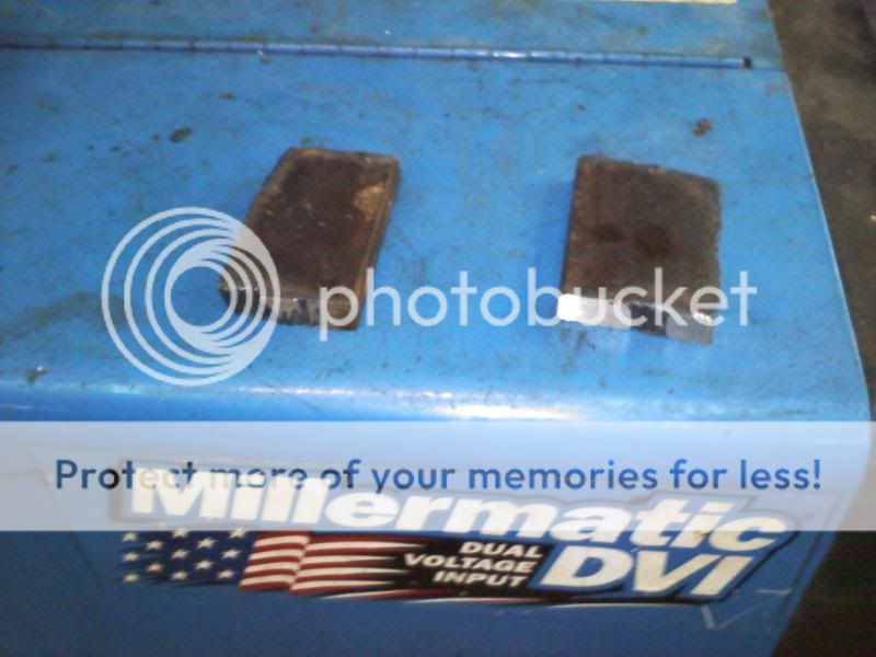

in my case, i chose to run with gusset plates for added insurance.
bing bing, one on right was trimmed after this photo.

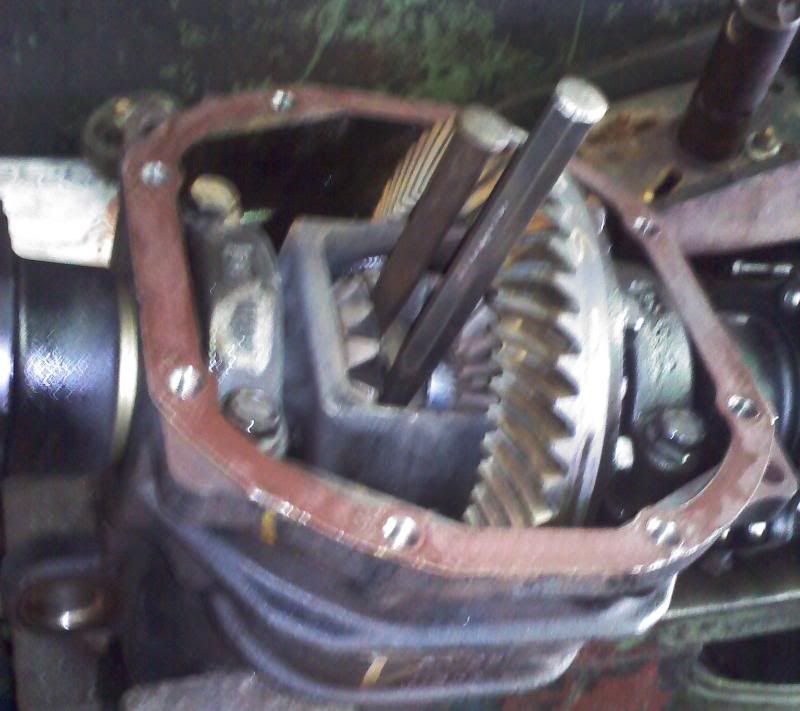

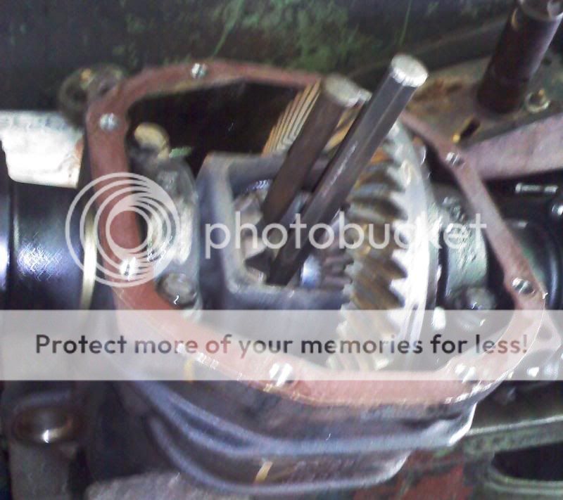

Step 3. SECURE THE DIFF!!

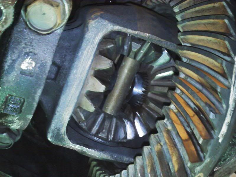

also secure the ring set as shown, tack weld the top of each spider gear on both sides, make sure tack, turn, tack turn, or you'll overheat the bearings.

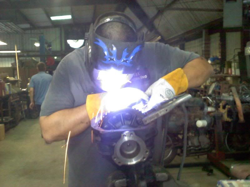

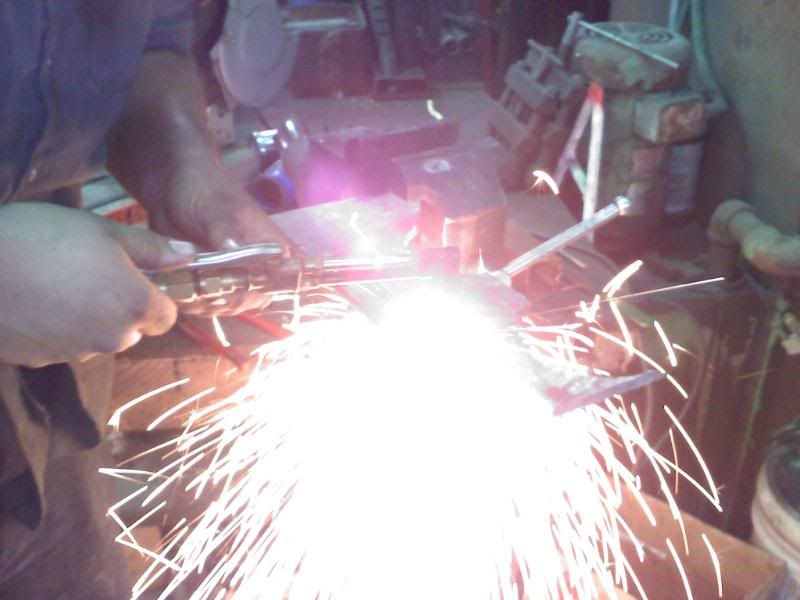

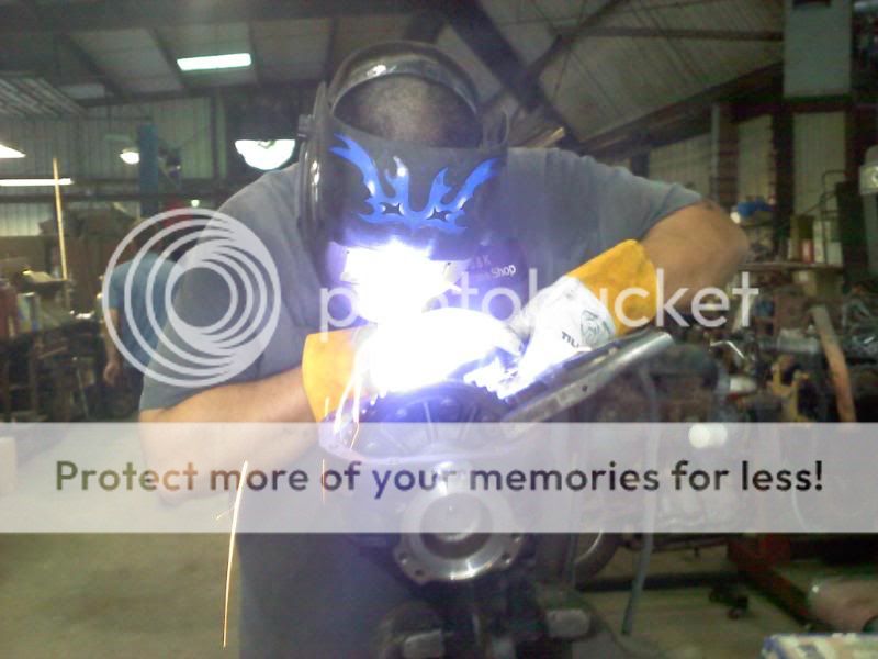

Step 3. WELD!
usually you can just fill in the ring set, but as shown, i chose to run gussets, you can see the fill around it, do so similar without the gussets, weld, turn, weld, turn

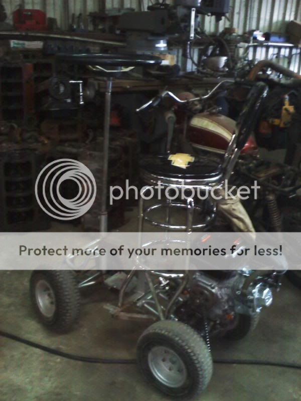

Allow cool down as necessary, i chose to let it cool with the all the filler, so while it did, i got to ride this sketchy bitch for about 45 minutes....
Why Bar Stool?.................... Because Racecar.
then, throw in 2.5 quarts of the cheapest 75w90 you can find, install it and rape face (on the track).

^x2. I was thinking of using the gusset plates on my next welded diff I get done, I know you havent had it for long, but in your opinion do you think they make that much of a difference?
I'm sure in the long run, those gussets will help a ton with all that abuse. I've never used them, but it's cheap and easy insurance on the diff.
I love any write-up with pictures. :bigthumbu
I'm sure in the long run, those gussets will help a ton with all that abuse. it's cheap and easy insurance on the diff.
there's your answer...
i did the gussets for that added insurance, i know that at any track the LAST thing to fail on my is going to be the welds in my diff. and when i drive 2-3 hours to an event, i want to make sure at least my diff wont be the reason i can't make it back. before he set the gussets, he filled in all around the spider gears, even looking at it at the time i was like "well, fuck, i could leave it just like that, that's a lot of metal!" but i decided to ahead and do the gussets.
reliability, and resale. when i eventually get back into a 2way LSD, this diff will be worth a whopping $10 more than anyone elses, due to it's known, and over built assembly.
