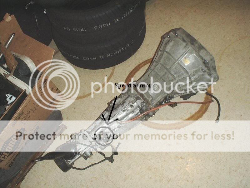

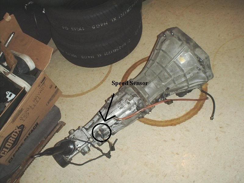

Hey whats up guys, my speedo stopped working out of no where. I'm thinking its the speedo sensor. I think it's connected somewhere to the tranny but I don't really know what I'm talking about. If anyone can tell me where it be at, I'd appreciate it.
^^^ Type of speedo I'm talking about, in case you didn't know.
On most cars it's located on the axle, or sometimes in the trans.
its the sensor with the longest wire coming out/going in and dont over tighten the bolt when you put it back in because it snaps VERY easily

fail thats not the speed sensor its the one below that on the bottom right hand corner most of the time this is reason for the speedo to quit i have a few in stock lmk.
haha...I just noticed the plug under the one i pointed out....My eyes played tricks on me dude, the older you get, the more you start realizing your getting older..haha
Bill is right, its the one right below the one i pointed out. Sorry bro, but before you go crazy with your tranny, check all of your fuses, inside the car and out under engine bay
