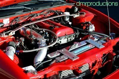

ill show you some pictures of some mid-mount setups
hang on
see how the intercooler is close to the rad
doing this doesnt let the air escape before flowing through the radiator
also you lose a lot of piping meaning better throttle response
heres some more pictures of mid-mount setups to give you some ideas
