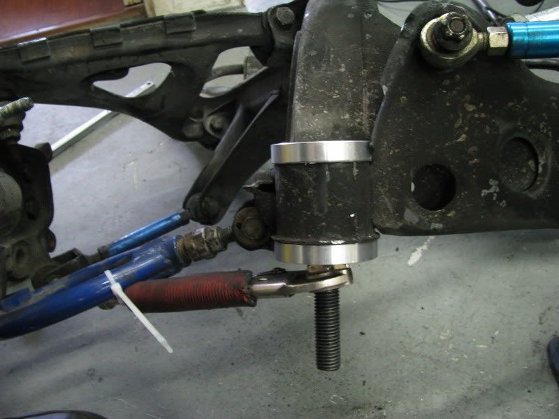

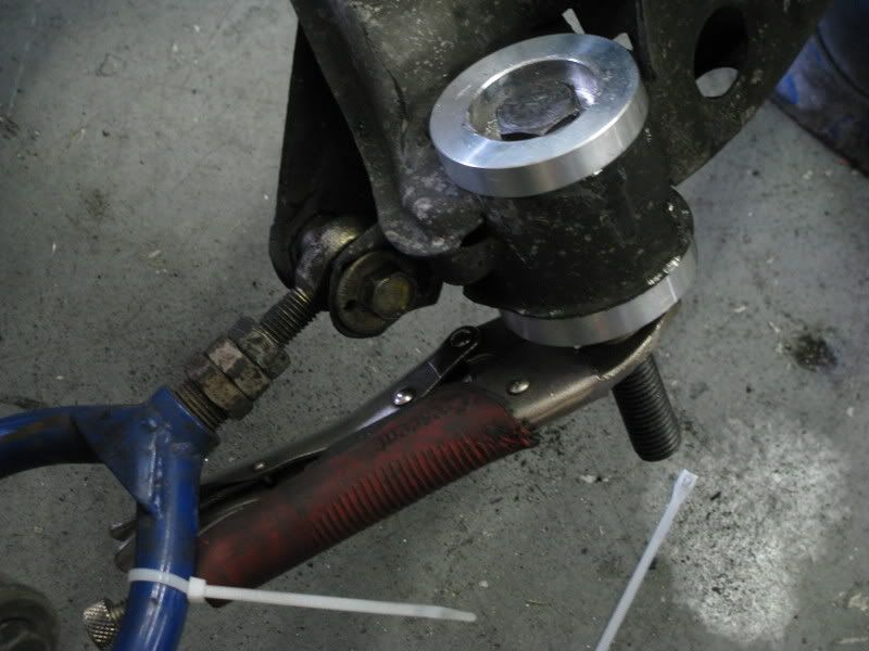

I just installed aluminum bushings for me and Jose's car.
I used air chisel to remove the center piece, and outer bushing. Be careful it will rip through your subframe.
If the bushing gives you a hard time, use a sawz-all or hack saw to cut through the bushing. It will come loose.
For install, I took the spacers to Broward-Bolt, and got the biggest bolt to fit throught the spacer, and a washer and nut to go with it.
Position everythng on the subframe and tighten away. I used 1/2 inch wrench, sometimes you might need a mini sledge, just a few whacks. tightend first subframe with wrench, then tightend other subframe with air gun (VERY CAREFULLY).
Then to install into car I used Hand 1/2inch wrench, using a criss-cross pattern on the 4 bolts.
It was alot easier than I thought, take your time, and dont put the bushings on upside down. I did this work with no lift or press.
I had cheapo E-bay bushings, Jose had SPL bushing, both went in easily.
