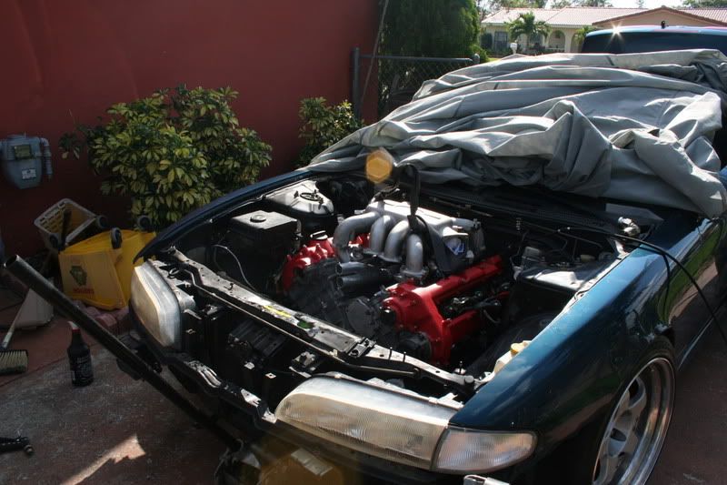

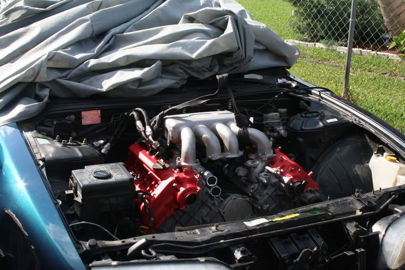

G gsracer BANNED Driver Apr 12, 2007 #47 Well to update, I have replaced the timing chain. Cleaned the engine thoroughly, and ready to drop it back in.
G gsracer BANNED Driver Apr 13, 2007 #48 Finnally got all the fittings in , now i can put it back together

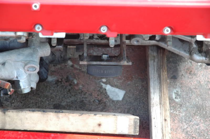

etxxz Driver Apr 15, 2007 #50 TRANSMISSION?? has this swap been done before? and are those hockey pucks for engine mounets?? is that safe???
jtmroczk Driver Apr 15, 2007 #52 etxxz said: TRANSMISSION?? has this swap been done before? and are those hockey pucks for engine mounets?? is that safe??? Click to expand... http://www.ellisautoworkz.com/services.htm http://www.ellisautoworkz.com/450swap.asp http://www.ellisautoworkz.com/cars/450sx.asp Last edited: Apr 15, 2007

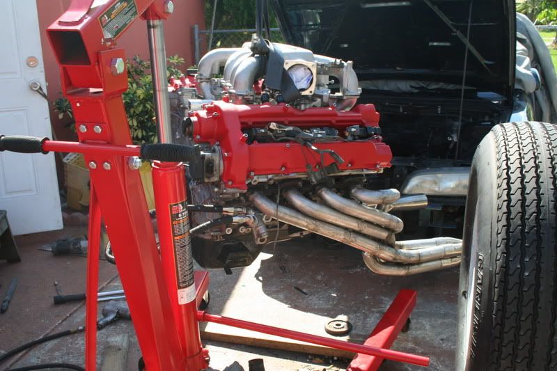

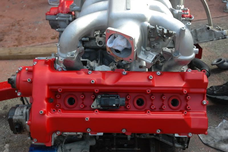

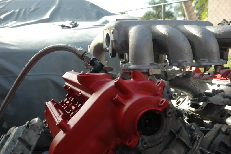

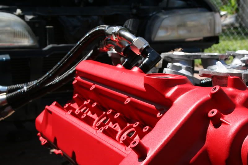

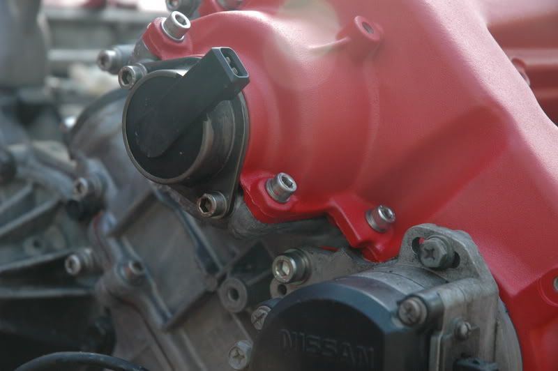

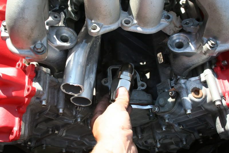

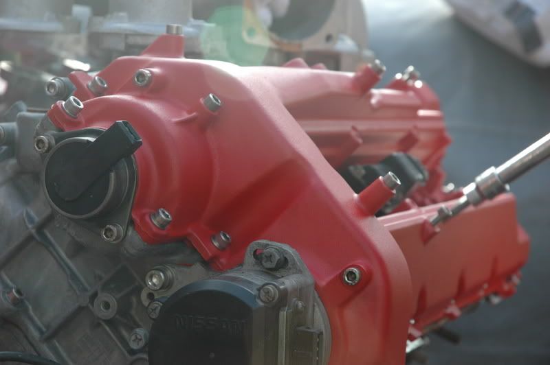

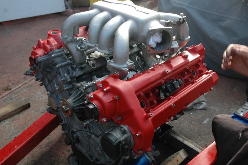

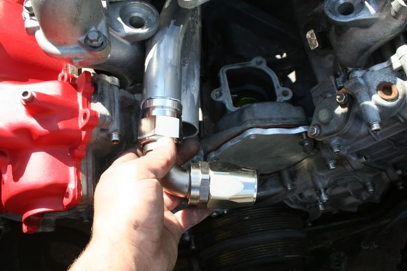

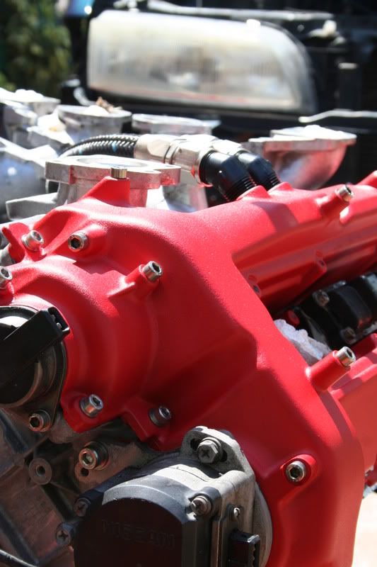

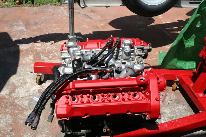

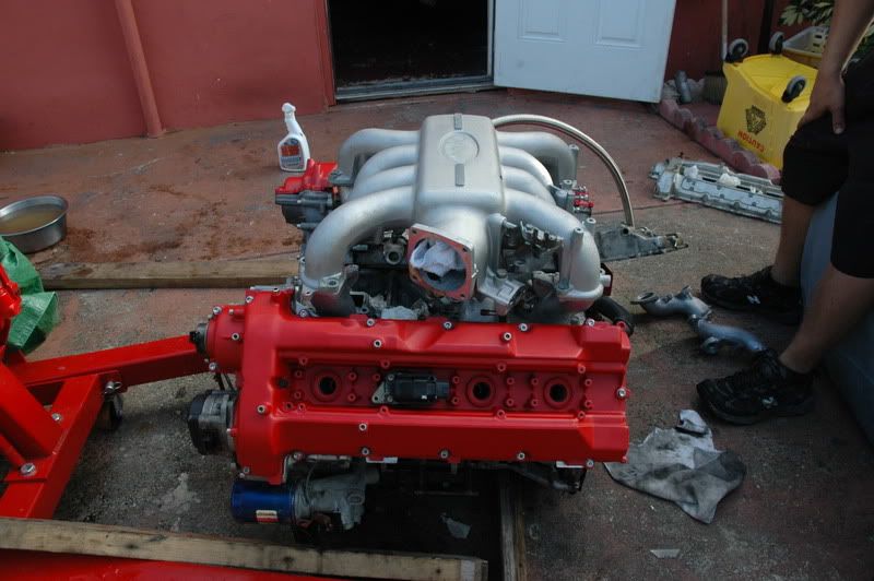

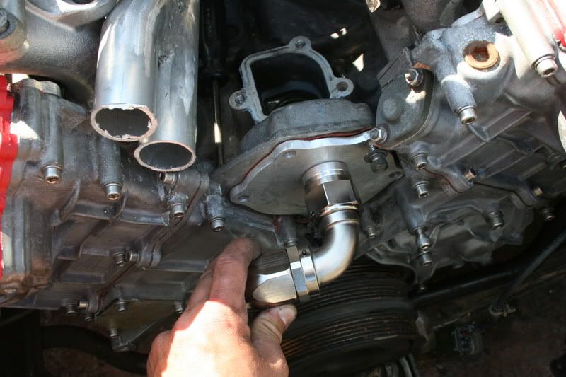

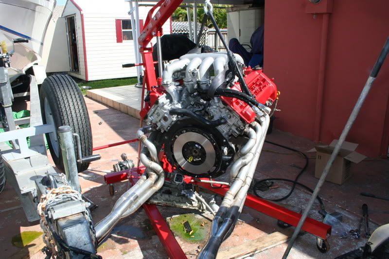

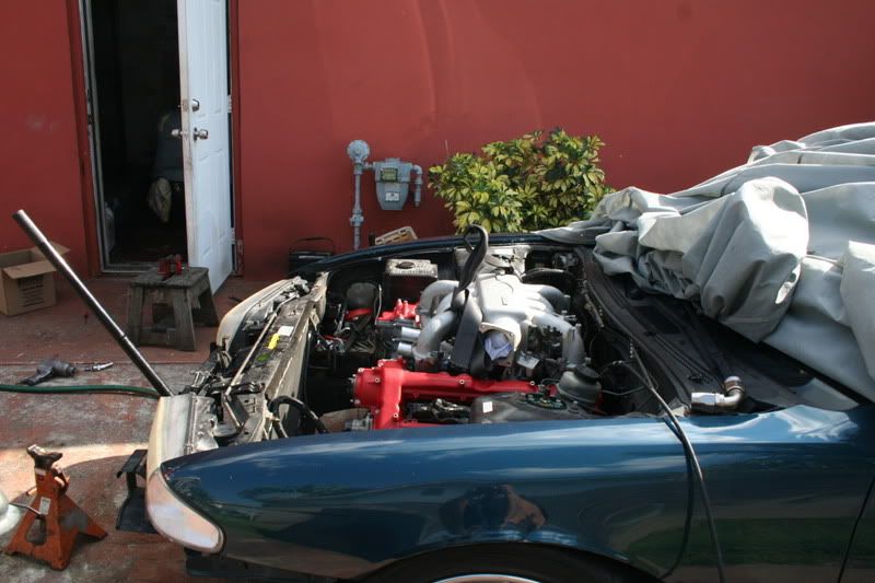

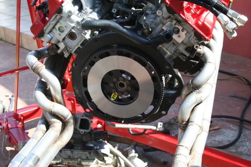

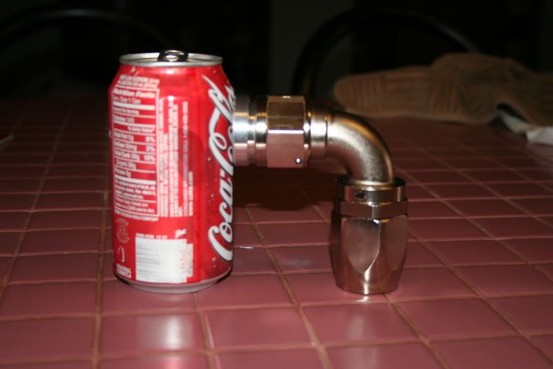

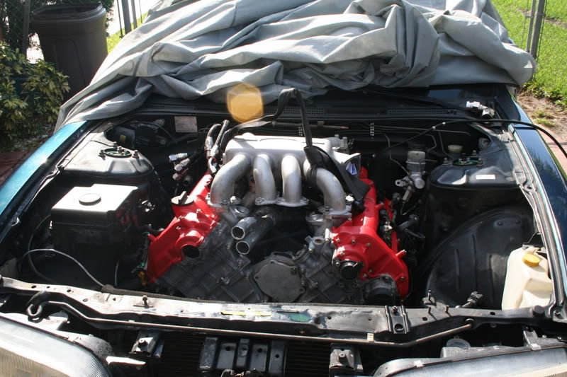

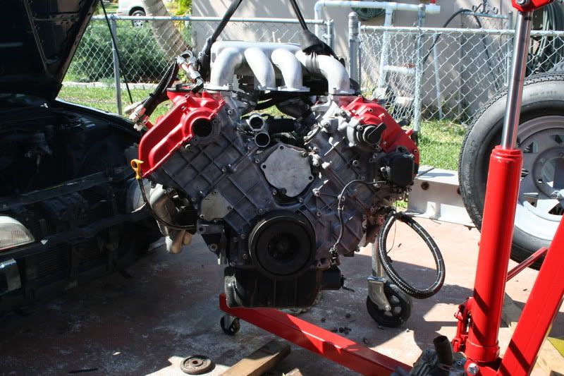

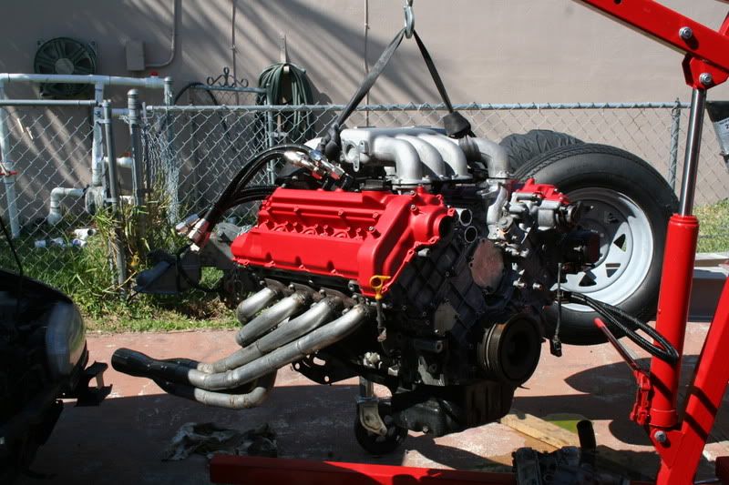

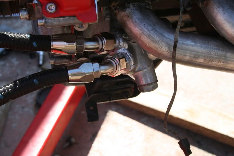

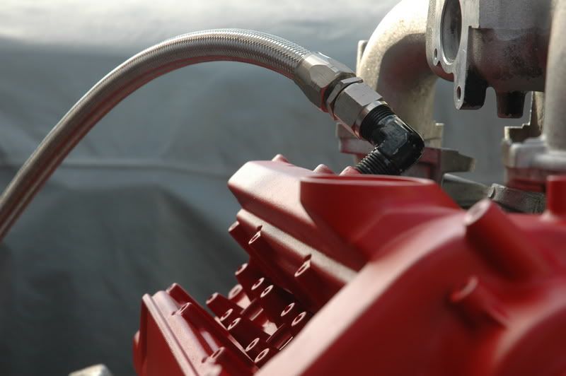

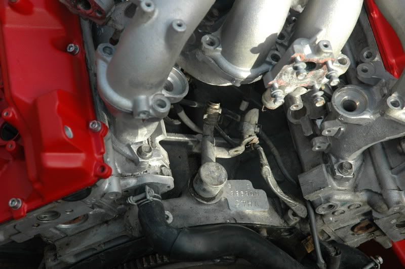

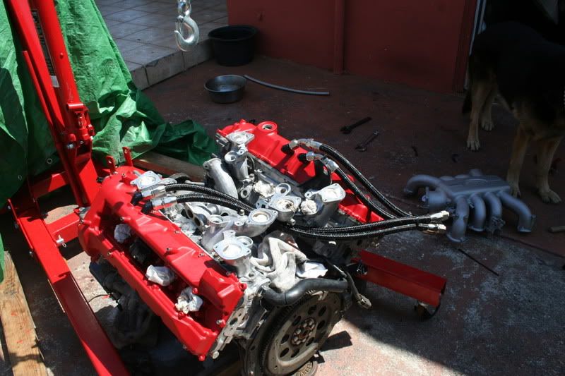

G gsracer BANNED Driver Apr 19, 2007 #57 Heres the latest progress. Custom making a few things, the tranny will be here next week, so I'm putting the motor back in the car to get the rest of the stuff ready. Water pump block off plate for electric water pump Motor on the hoist about to go in My first attempt at welding aluminum, dont laugh... Seriously. For remote oil filter mount Back view 12 lb chrome moly flywheel -16 AN fittings for water lines, two in, two out Here it is back in again after powder coating and cleaning
