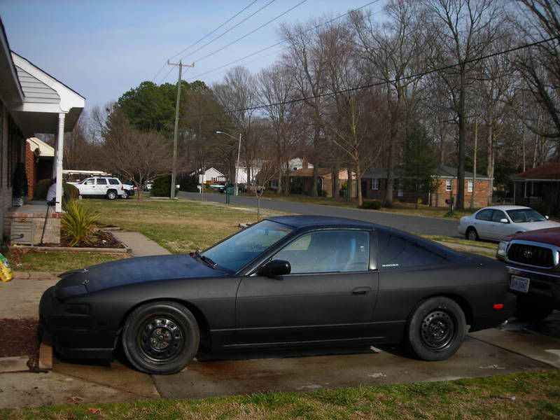

Cost me $40. The only hard parts as you can see in the pic are the hood/roof(big area), the rest of the car came out very even with no splotchiness/striping. Biggest mistake people make is buying the cheap paint, like $2 can stuff. No matter what kind you get make sure it has the "fan" spray nozzle, sprays a much wider surface so you don't get the striping look.
