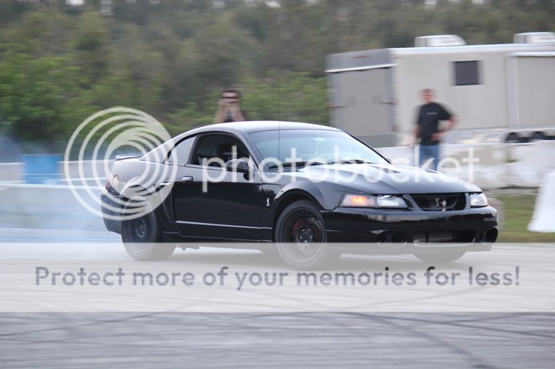

My go pro videos of county line skid pad jul 21st
went back for the third time , getting better was able to do the whole course without spinning, sometimes,lol

It seems to me that the seats are a bit too large to hold you in place, hence the reason you are using your arm as support on the door panel. I've sat in a few Corbeau buckets before, and they are too big for me, and although I'm not the large type, I can fill up a seat quite well. They are comfy though. lol. Maybe a decent set of racing harnesses will help you stay in place.
Another thing to note is throttle modulation. The steadier you can keep your throttle, the smoother your car will slide. The problem with your car, and all Mustangs 2004 and older is steering angle. Any time you get on throttle, you immediately go to full lock with no where else to go. Well, until you get more steering angle, you will have to learn how to throttle modulate a little less aggressively.
Luckily for you, and pretty much any 1979-2004 Mustang, there is a solution for steering angle. Doug Van Den Brink has these knuckles and control arms for the Mustang for more angle. The stock "A" shaped control arms on the Mustang limits the space for the wheels, which is why these have that odd shape.The knuckles have a shortened steering arms for more angle and the spindle has been raised on the knuckle so you can have a lowered car without sacrificing suspension geometry and stroke.

Yes, i was holding myself with the arm, i am not big too. For now i will leave it like it is, until i decide if i am buying another car for drift or spend money on this car to make it better, if i decide to spend money on the cobra i would put cage, front suspension and hand brake. Whatever i do, it will take time so i will just enjoy the skip pad for now. But appreciate the help, i am taking notes:bigthumbu
I would also like to add that if anyone on this forum knows 03-04 Cobras, it's Rhythm_Drifting (Will Barnette, sp?). He could definitely help out.
Anyway, I see progress in your driving. It will only get better with more seat time. Keep it up, and have fun.
