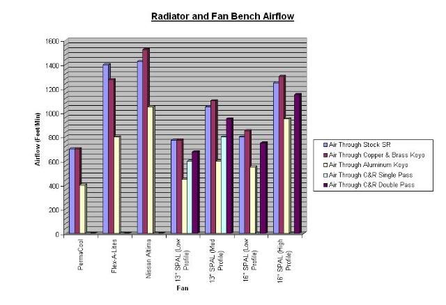

Interesting radiator and fan comparison i found
Just get ISIS Dual electric fans and a radiator (Koyo.Mishimoto.etccc)
i been running these for about a year now with road course event, daily, skidpad and my sr hasnt once overheated.
im getting a koyo, and im probably going to do altima fans since they are cheap and according to that study, push/pull some pretty good air
i just posted that for everyone else to read. Some of that is interesting and good to know. I was suprised at how big a damn cardboard cooling plate up top made

on the real though, the aluminum shroud with the fans do look nice as fuck. ryans got em. just for now the altima ones are a lot cheaper, and every dollar i can save counts. Plus if you read that article, the altimas outflow the cheap aftermarket fans. They didnt test the isis though

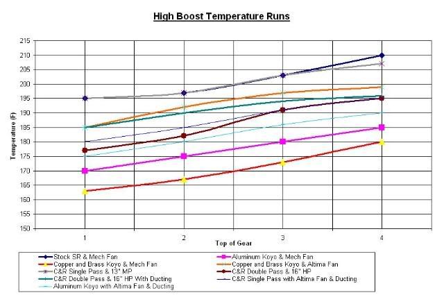

heres a graph

Not sure if thats sarcasm or not, but the clutch fan with no shroud and stock radiator has worked awesome for me so far, daily, beating the piss out of it, and drifting, but check this out

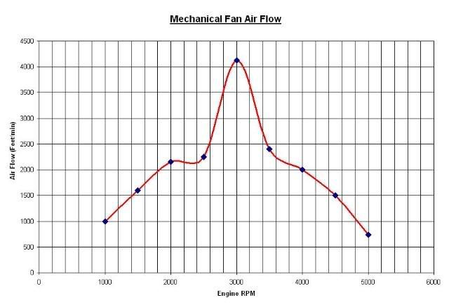

but also
That graph shows that a copper rad with clutch fan outflows and aluminum rad with clutch fan, I don't know if I believe that at all.
I used to run a copper koyo, and my aluminum koyo keeps lower temps.
if you read the article, it tells you which tests are more accurate and what they used to measure them, how long they drove for, starting temps, etc.

its to show people the comparison results of the different radiator and fan combinations because i found it interesting to know. Also shows how big of a difference a simple cooling plate makes in driving temps. And other info that is good to know since we live in florida and it gets hot down here
