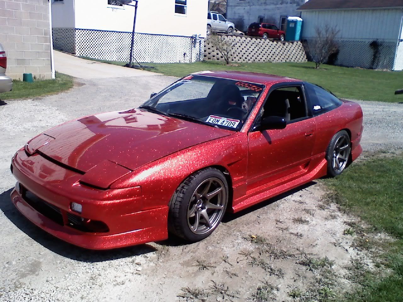

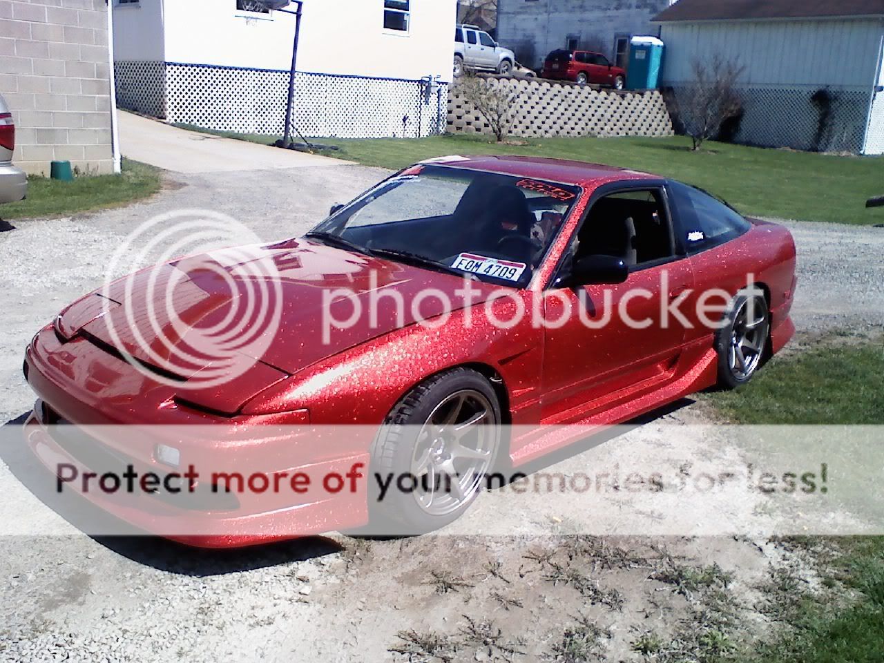

Its paint, i did it in my garage back home. here...
fixing all the dents and what not
first coat of primer
HOK F20 red
mocking up the whole kit
first coat of black base
again
first coat of flake
second
third coat
fourth lol
first time cutting and buffing the clear
i have a big build thread with pretty much all the pics on s-chassis under show an shine
damn
did you need a special gun to spray that big of a flake?
and how much did the paint run you?
also thats weird how you put down a black base first
no, all i had was a POS porta cable $90 gun, just used a 1.4mm tip. with the first couple coats i didnt have enought flake mixed (at the time i thought it was a lot) but i played around with it on the 3rd coat and came out better so i did 5 coats total.
I got everything at API (dunno if you guys have any down here) but i had gotten wholesale on everything which came out to be almost $1100.
I did a black base so the difference would be more aggresive and be a bolder red. if i went yellow or orange base, it would have came out to be much lighter and have a hint of that color in it.
but the way i put down the flake is different then what most people would have done. most would have put a black bas, then mixed red into the flake.
I used PPG deltron color blender and reducer which came out to be a clear so its pretty much just a clear coat by itself but I mixed the flake into the color blender so it comes the color pops out more.
in all honesty, i got lazy with the clear and cutting/buffing the clear so theres still a ton of dirt spots that are visible, the finish isnt the greatest and the body kit fits like sh** since i went with an ebay kit but i areally want to track it and i didnt want to spend like a grand and then fuck it up lol since ive never drifted on a track lol

thanks man, this would be like my 5 whole car, ive painted alot of misc. car parts.
mmm 4 stage if sealer coats? idk it was only one fine coat
