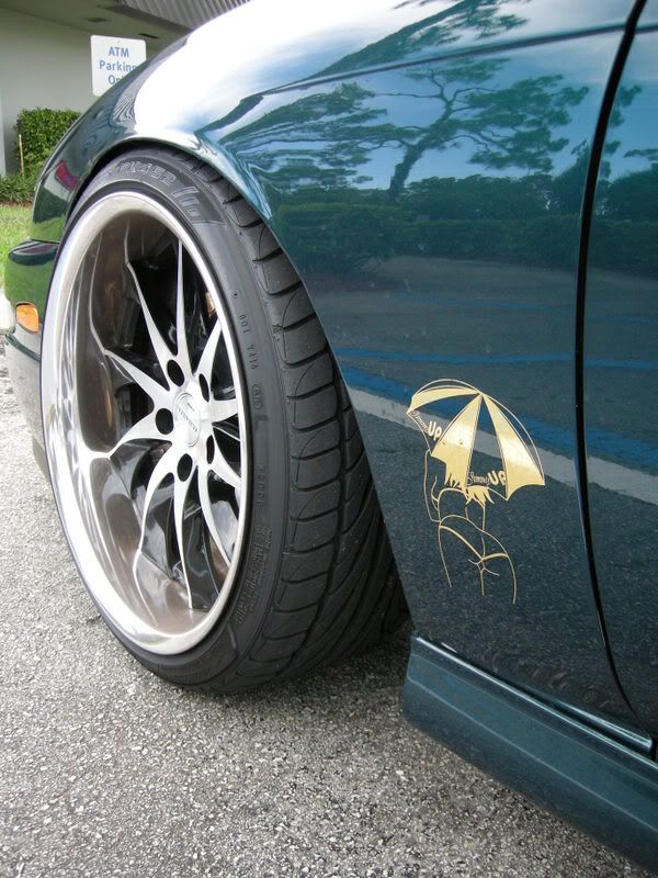

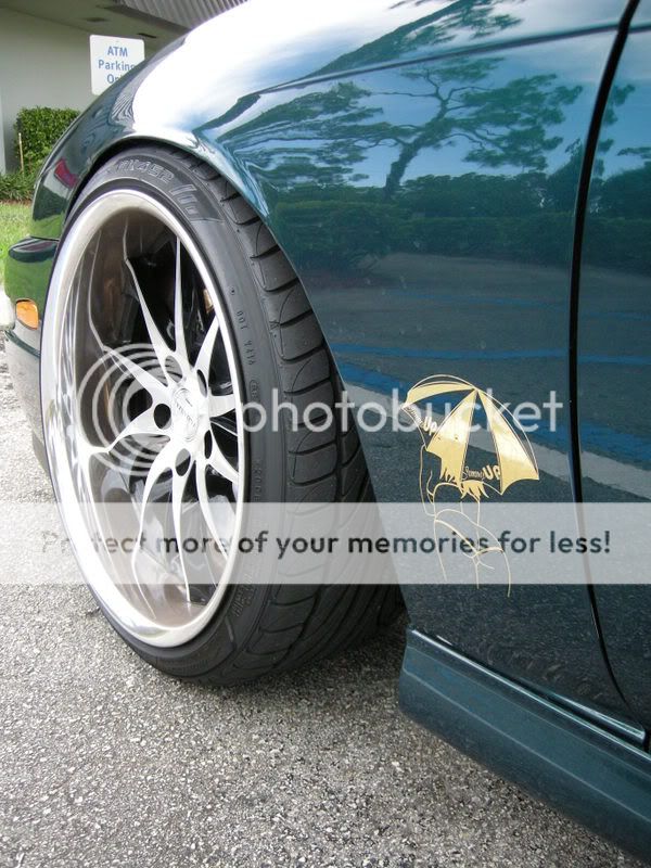

Back on topic, TypeArg I'm assuming this is for your is300 right? If so I'm glad you got a set of wheel that your going to have to make fit. I love is300's I would have gotten one instead of my s14 but I would have barely had money for suspension and wheels after the cost of buying a stock one. Post the specs on the wheels you want to run I'm very curious.
Yessir it is for my Is300, 19x9 +34 and 19x10 +38.. Let me know im getting my tires mounted today. PM Me # and pricing sir.
Not bad at all, I know it doesn't take as low of an offset to be flush with those compared to an s chassis. If I were you I would run a 5 or even 10mm spacer on the front depending on how much stretch your going to have. The rears on that set poke 9mm more than the front, which isn't crazy it's just under half an inch but I think cars look much better when the fitment is the same front and back. My friend just bought some used meisters that are 18x10 +5 and 18x12 -20, that shit is ridiculous a two inch difference in poke I don't know who ordered them from work but they fucked up. I'm making sure he runs at least a 15mm spacer up front (hes going to have 30mm overs front and 50mm overs back) . If you found any pictures of similar offsets on another IS you should post them, I want to see but I'm to lazy to search. Also what size tires you running?
