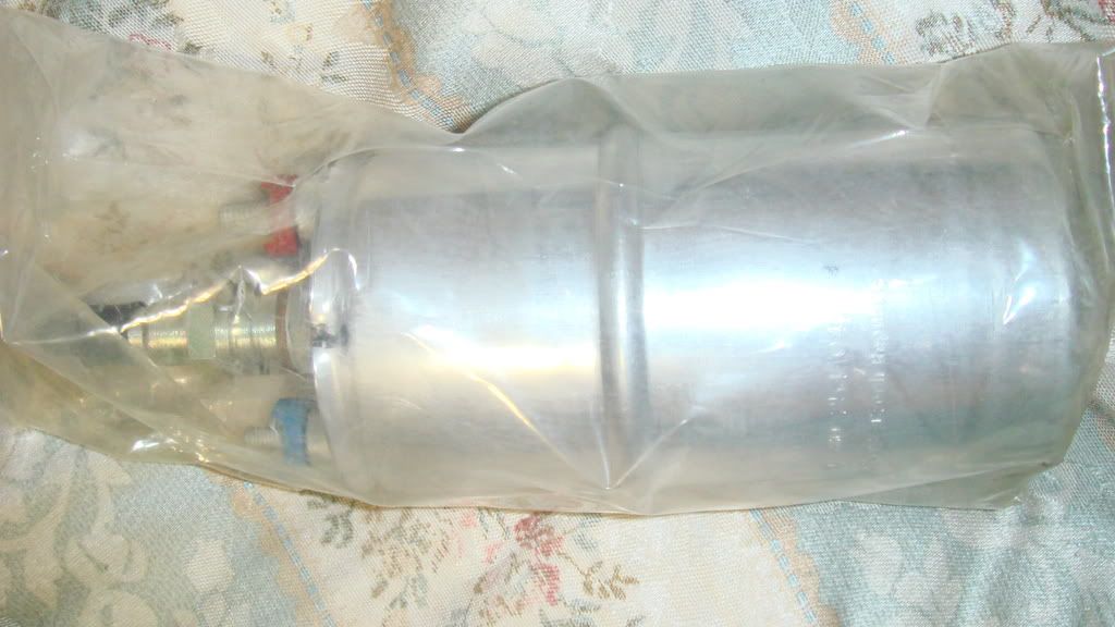

and d.davaine were you selling that pump b4? pm me if you have one
iv heard a good upgrade would be the supra tt fuel pump?
