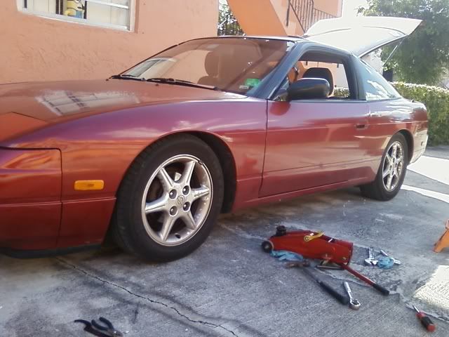

how my car sits now
---------- Post added at 03:06 PM ---------- Previous post was at 03:04 PM ----------
i have two 3mm spacers on the front and it still rubs, gonna try what boxmod said
