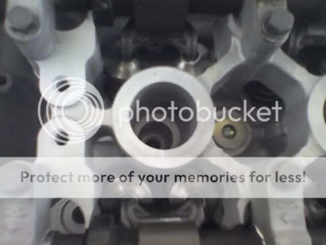

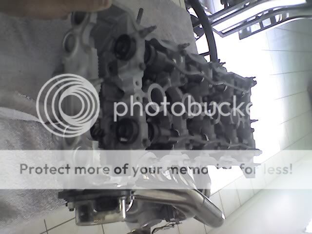

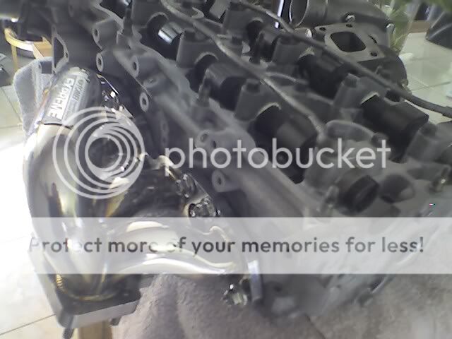

Didnt do any porting/polishing but pretty much replaced EVERYTHING minus the lifters in the head. Clearances checked/shimmed, new studs installed, decking, cleaning

Might be overkill but be sure to mention that the lifters be bled and the rocker/shims clearance be checked as well. Most folks believe that because the lifters are hydraulic they are self bleeding/adjusting and overlook these critical steps

OEM Seals (intake/exhaust)
OEM Rocker arms (All 8 New)
BC Valves, Springs, Retainers
Tomei Poncams
Tomei Rocker Arm Stoppers

Everything was in good shape besides the one rocker arm I broke - just changed out cuz my wallet was itchin :)

I might have the other rocker arms in the same box as the valves - gotta check - cant really remember what I did with those
Oh and a broken rocker means valve doesnt open so it drove like poo poo immediately (exhaust valves werent opening on cylinder 4)
