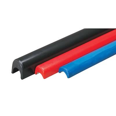

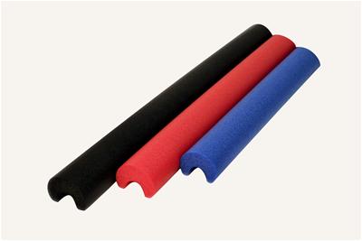

The area in question is specifically section B. There were a number of folks that rolled through with the pool-noodle style padding in the driver's head area. The concern we had was that it did not have a specification on it and as many of you are finding out, items with ANY spec on them tend to cost more and that may be a reason why. The other reason why is probably a mis-interpretation of the rules.
Summit racing sells roll cage padding and it's pretty easy to see on the first page when you bring it up:
http://www.summitracing.com/search/...gacre-ProTecto-Roll-Bar-Padding/?autoview=SKU
Key things most people pick up on are 1. the price (cheap) 2. the wording "roll cage padding" and 3. "flame-retardant" which leads you to believe this fits the bill and you proceed to check out. This is where the problems begin because these pads do not carry an SFI certification and as such they fail to comply with the FD Pro-Am rules for padding specifically to be used in the area where the head may contact it. The cheap padding is perfectly fine for door bars, down bars that are in the area near your feet.
On the page below, you'll see the SFI rated padding that you need.
http://www.summitracing.com/search/Department/Safety-Equipment/
It's the stuff specifically labeled "SFI 45.1 Roll Bar Padding" and will meet the requirements for the padding needed in the areas that will come in contact with the head. The SFI rated padding is "High impact, high density", " fire-resistant and gets denser as it's compressed". Where as the pool noodle stuff is "Medium-density padding".
When it comes to safety features in racing and standard automobiles, the ability of a component to absorb, slow or deflect a particular motion is how the driver and passengers stay safe. The SFI padding is $25.95 for a 3ftx5inch thick section compared to less than $5.00 for similar dimensions of the pool noodle. While the SFI rated padding may feel harder to the touch, cost 5 times as much and may not be as easy to work with, it's ability to properly decelerate the driver's head as it contacts the padding is what makes the difference between comfortable to the touch (pool noodle) and capable of absorbing impact (SFI rated padding).
