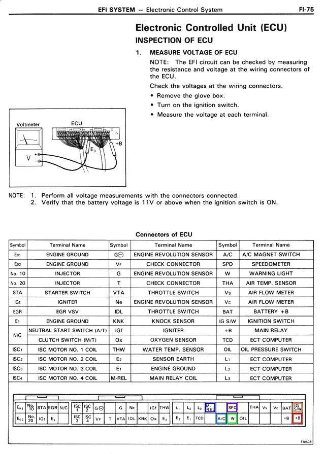

i have everything for the conversion but a 5 speed ecu. im wondering if theres a way to trick the ecu into neutral so i could drive the car, i cant have it immobilized much longer due to the city

I've heard a lot of bad things about trying to trick that ecu. I would go with the manual ecu if its an option.
its not really tricking the ecu. it doesnt affect anything. it just completes the circuit showing that its in park/nuetral so it will start. doesnt do anything performance wise at all to the ecu.

ok update, car runs and drives, issue is it wont rev high almost like fuel cut
update
ITS NASTY!!!! for some reason the nsw and sta wires were keeping the ecu in park with a rev limit. i snipped them apart and im redlining ! the 2jz in the coupe feels torque happy an quick. ill post videos soon
