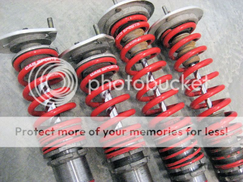

okay so i just put some GAb coilovers on my car, they came with helper springs but they are currently off the car so that i can drop the car more.... only thing is that this car is so unstable, it wobbles around and feels like if i hit a turn too hard i'll fly off into a ditch. Will putting the helper springs back of fix all this chaos? i just want a car that handles well and looks nice but if i have to pick one it will be my safety... Thanks for your input guys :bigthumbu
also i have been driving around and when i slide with my tail out to the left (right turn) it hops around and vibrates like crazy (seems like its coming from the right) but left turns it slides just fine.... also when i go over deep holes i hear a loud clunk sometimes coming from the rear right side.... and i just aligned it and it hasn't fixed shit!

Depends if its really just a helper spring and not a dual spring rate setup.
If it looks like this then you can take it out
But if your setup looked like this then put them back.
they should look like this...
should i put them back on?
