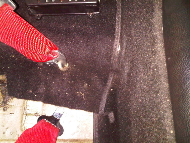

They go over the harness and angles pretty well so I'm going to move on to the next area of concern with harnesses which is the means of attaching it to the chassis, frame or roll cage. I saw a number of guys who bolted their harness right to the floor or seat brackets which is really bad.

The biggest thing you want a harness mounting fixture to do is be moveable. It needs to allow for some movement changes throughout the driver's range of motion but also not strain the harness in manors it wasn't meant to be in the event of an accident. Most guys see an eyelet at the end of a harness and assume "Insert bolt here, tighten to floorboard" which is seriously bad. A metal triangular plate is meant to be held in to a bracket which allows movements OR bolted to a roll bar in such a way that the bracket can still flop around but NOT come off. See figures 1 and 2 in the link above.
Some harnesses come with clips on the end rather than an open eyelet. These clips can easily latch in to an eyelet that has been properly welded or bolted in to a fixture point.
When it comes to a harness, the more movement at the fixture point the better. However, keep an eye out for potential snags and opportunities to tear a harness. I've seen some really nice harness be put in harms way because they were bolted behind the driver yet laid across a seat track corner. This would have been bad if they fella got in a wreck but even regular use would have frayed his perfectly good harness.
Fatigue can come in any number of ways. Repeated direct sunlight exposure, water absorption, tears on edges inside the car or exposure to human oils and dirt/debris. Ultimately, having a harness that can be removed quickly and stored in a dry, safe place should be something you put in place. The harnesses may expire in 3-5 years but the damage may come a lot sooner if you aren't careful.
