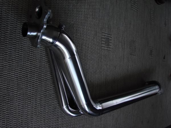

-custom downpipe as the stock dp will rub the steering shaft locking your steering

i saw that link already and thats what has got me thinking about it again.. that stuff that you have said is not that bad i can do that np. right now im in the process of taking my motor apart and replacing all the gaskets and whatnot. but the downpipe will need to be custom huh. and as for the stock turbos are they good or not i dont get it?? im talking about the ceramic wheels.
well you can do what i did and buy the AMperformance downpipe. they have 2 the screamer and the stock one. the screamer is open dump.

About the downpipe: I was going to cut the dp before the steering shaft and have a muffler shop weld a downpipe from there. I can't find a link for amperformance. How much is that dp?
