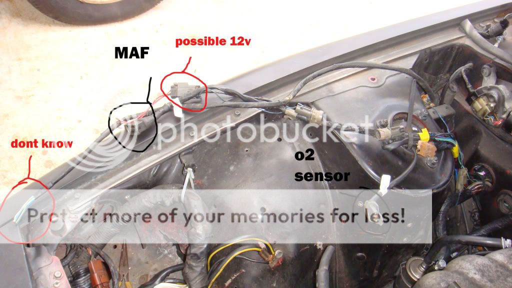

not yet lack of money time and not knowing exactly what to do.... but once i make a switch panel i should be getting back on the ball
The one that is marked"12 volts possible" is not used on my RB20 (Silver top)
I dunno what it is though.
I'm only guessing stock Boost solenoid plugs?????? (since its on the same length as the MAF)
holy hell is that the only thing on the harness? there isn't more? you're going to have LOTS AND LOTS of fun.
why not just convert to the RB20DET Silver top wiring? just a question.
well the rest of the harness is plugged like the injectors and shit, but the harness pictured should be going somewhere in the relay box area for like fuel pump and crap.
call him and send him pictures he is pretty good about stuff like this pm me if u dont have his number
