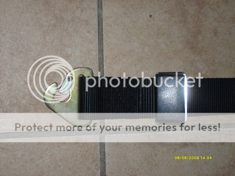

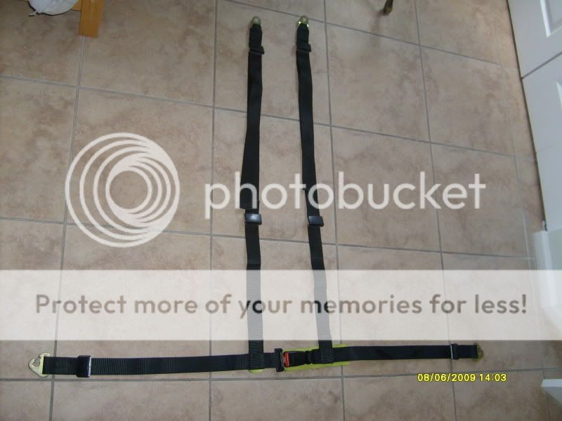

idk if im on the rite section but here it goes i have this harness:

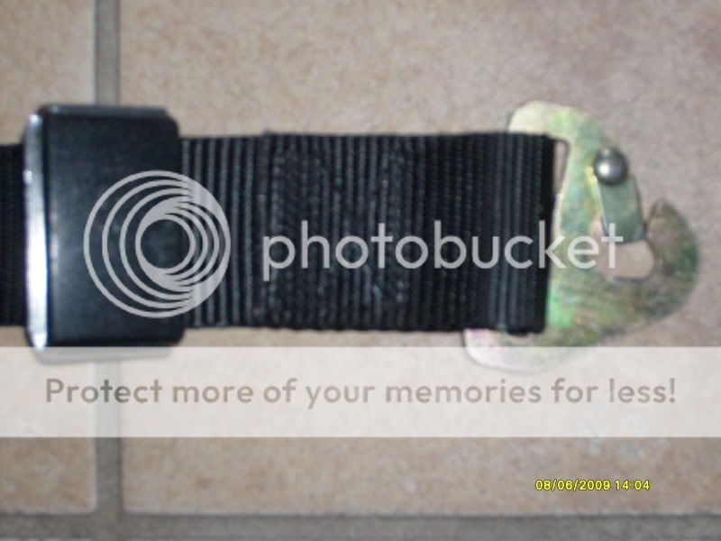

that im trying to put on my s13 hatch. i decided i could bolt down the top two holes to where the seat belt bolts go for the back seats. but wtf do i do with these:
cuz these are clips so where the fuk am i supposed to clip them on too?
