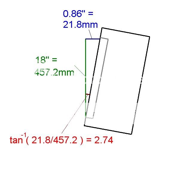

But yes technically you could figure out in inches what a degree of camber would equal on your wheel by using Pythagorean theory or what ever that was we learned in geometry to help you determin the sides of a triangle your triangle will be how ever tall your wheel including tire is from center to top the other side will be at what ever angle it is that your alignment is away from the first line it will be the same length now all you have to do is figure out the missing side.
Now that is a really simple way to figure it out But it won't be exact because offset plays a role in the arch of the top the wheel makes when you add or take away camber but it should give you a pretty close idea
http://www.negative-camber.org/jam149/technical/alignment.html
If you mess with the equation you get tan(degrees of camber)*length of rod=distance from fender
