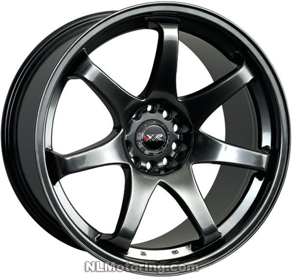

alright guys i am about to buy some rims from xxr, they are the new 522's, i am thinking to get the 18's, i do not know anything about off sets and i am not sure what would look great.. the offsets available are 48, 30, and 25... i have z32 calipers so they would need to clear those... thanks for the help guys :bigthumbu
some dude says these are gullflames (i have no clue but i thought they were the same)
