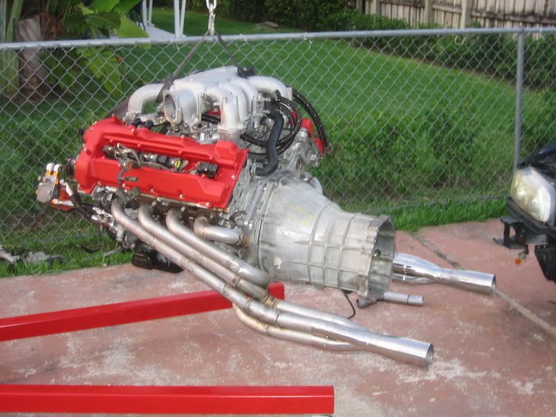

The Vh only weighs about 75 lbs more than a 1uz, in my opinion its a way better motor, the heads flow more and it has more desplacement and a broader tq curve, but im biased i guess.
as for the headers you can make your own or buy the mazworx ones, i recomend the mazworx ones as making them yourself is a headache even if your expierienced.
Heres pics of the two sets of headers i made, the ones on my car right now are the mazworx ones.
These are the ones i made on abes RHD s14
These where the ones i made on my first vh swapped car.
