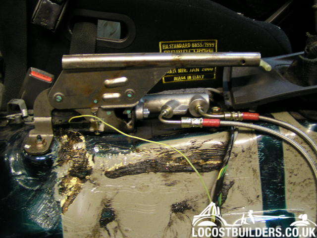

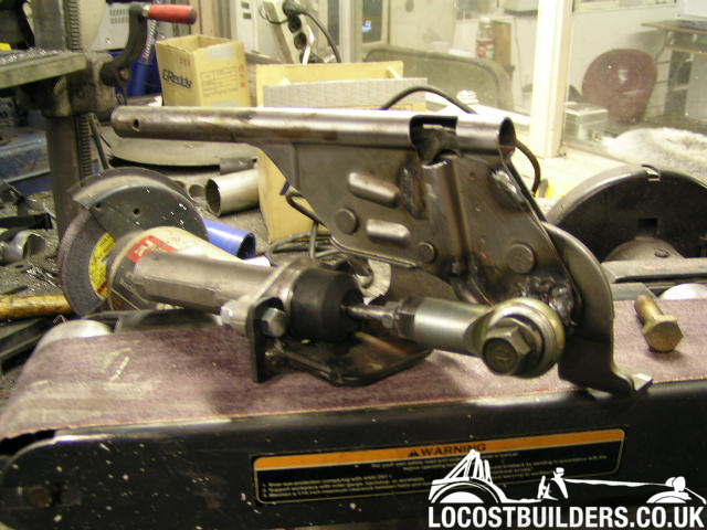

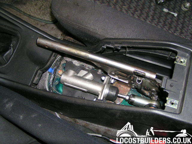

I built it. Materials cost about $150 including master and lines and it fits under my center console with my stock Ebrake ratcheting mechanism (with drift button). I can build one for you too if you want, or you can try to do it yourself.
