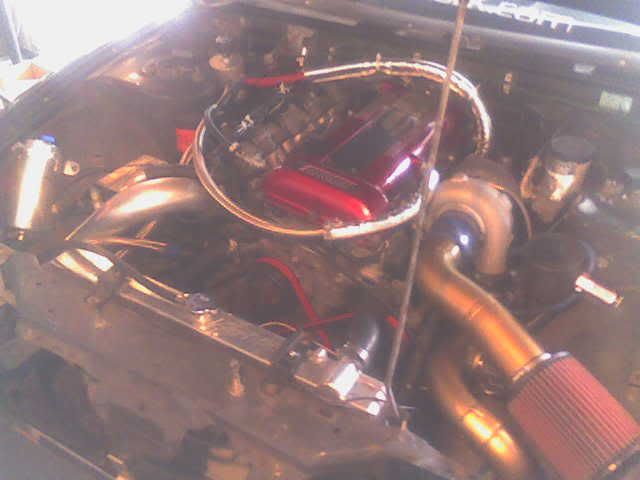

one of the guys up here just went with the topmount enjuku setup and hes running 16 lbs of boost daily..no problems so far...too be honest i dont know what kind of manifold he is using.
