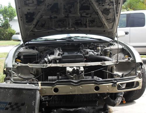

Though the R154 was giving out on me.. I start the car up this morning and I hear is kilnk klink klink bang... SQUEEEEEEEEKKKKKK ..... Reaction "What the fuck is that now. POS Car.... " My Crank pully is fully detached...
Suggestions???
Well hopefully it's one or the other problem.. If it' both, I'm definitely getting rid of the motor..
Awesome.. That a plus..

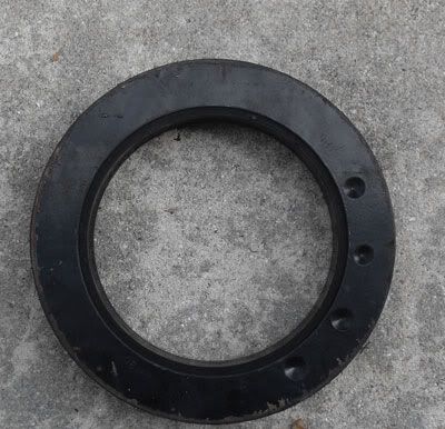

Actually reading right now, it's somewhat common on the 1j and 2j.. The rubber in the inside ring cracks and wears and pully just falls off..
Now its a question whether to run a harmonic balancer or aftermarket underdrive pulley?? I've had bad experiences with underdrive pulleys on other cars in the past.. Any more suggestions?
yea that is a common issue with JZ engines with the rubber in the crank pulleys. Just from wear and old age.
Unless you are going with a Fluidampr or ATI harmonic balancer... then stay with the stock one (those lightweight crank pulleys are garbage and will fuck your shit up). I have a stock one for $40
Actually after a while alot of crank pulleys that have rubber insulators go out after a while remember you really don't know how many miles the motor has. Go with a stock crankpulley if you use a aftermarket pulley made out of aluminum you will upset the crankshaft since its not balanced from factory.
Hmmm... That's what I figured. When working with Honda's and aftermarket crank pulleys, they have horrible tolerance. I've seen pulleys on b16's b18's b20's and H22's and on a few of my b's and my h's it just destroys main (crank) bearings(if you consider sliders bearing) (somewhat off topic), I don't want to test the crank of this motor at this time.. Some other time when I have resources of my disposal, TIME, and to make life easier a car lift so I can remove the engine and tranny.(I don't need a lift but it would be nice..)
