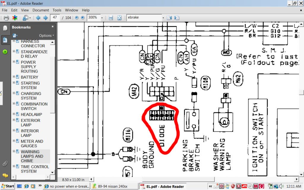

so all my dash light goes out n i get no power in the car when i pull the e-break down. or when i put it in gear. there was nun wrong with it before. just dont know why this happing. can it be a ground? NEED HELP!

check diod pack promblem is likely there.
