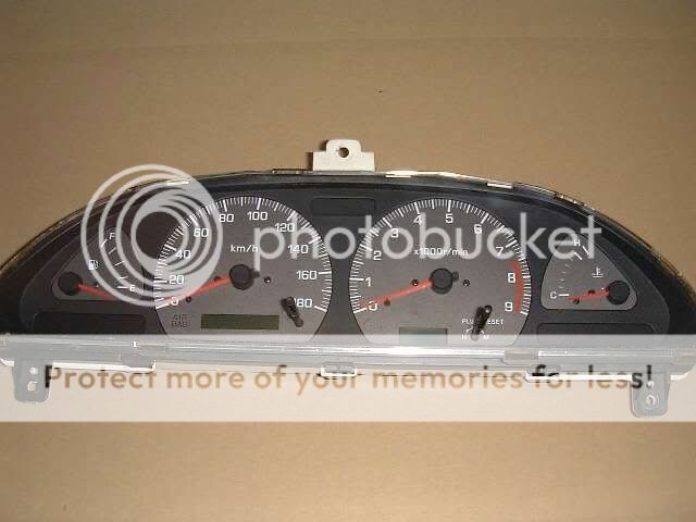

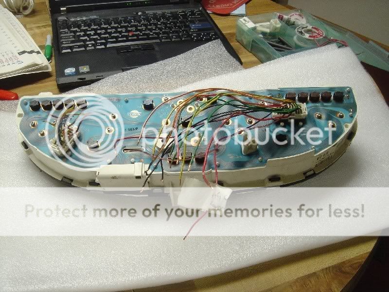

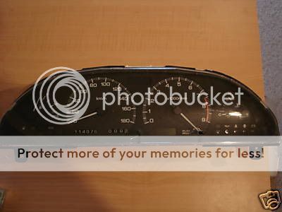

Ok guys. So I got my hand's on an JDM 180SX Type-X cluster. As some of you may know, this cluster is a lot different from the USDM 240sx cluster, the wiring will have to be redone which means if you want this bad boy on your car, you're gonna have to do some cutting and splicing to your cluster harness.
For reference here's what the cluster looks like:

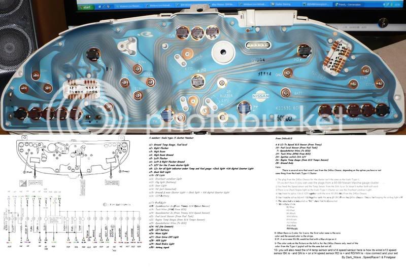

Now, I did a wiring diagram with a couple of friends. This will help you during the process, now I can't obviously teach you wire by wire, if you don't have any electrical experience, then I suggest you don't tackle this job, as it could get very risky and confusing.
For those that can, here's the wiring diagram:
Like I said the diagram will help you out

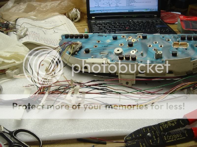

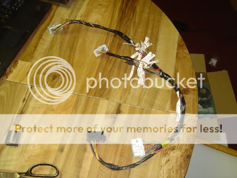

Here, I removed the tape around the kouki harness...
I bought a spare USDM 240sx gauge cluster harness, just incase I want to put mine back in, but as it looks, i probably wont ever do that, since this just looks so much better

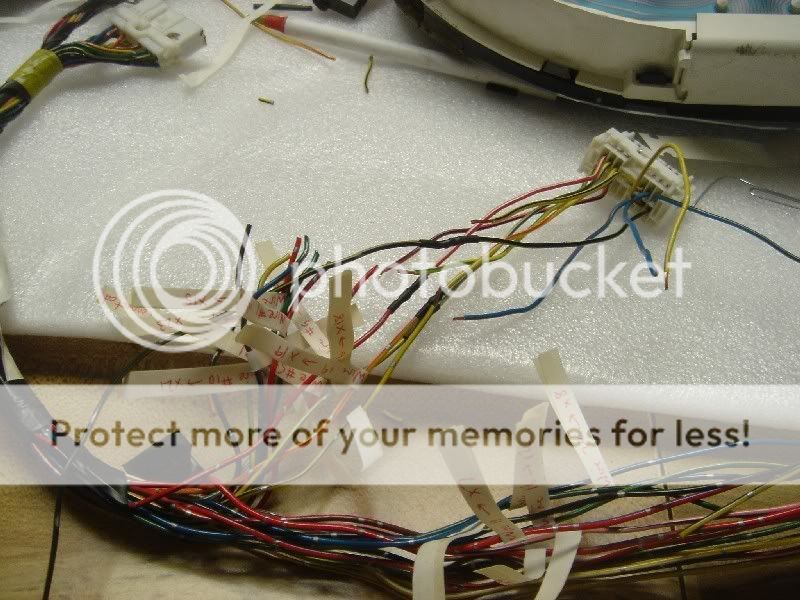

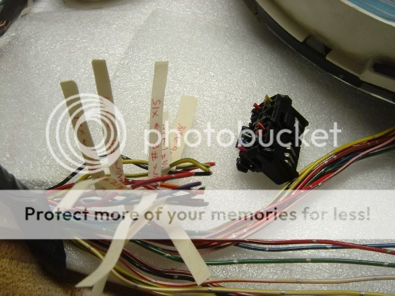

You need to identify all the wires, i found it easier to label each one...

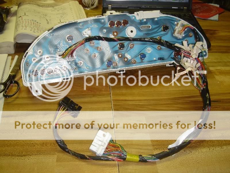

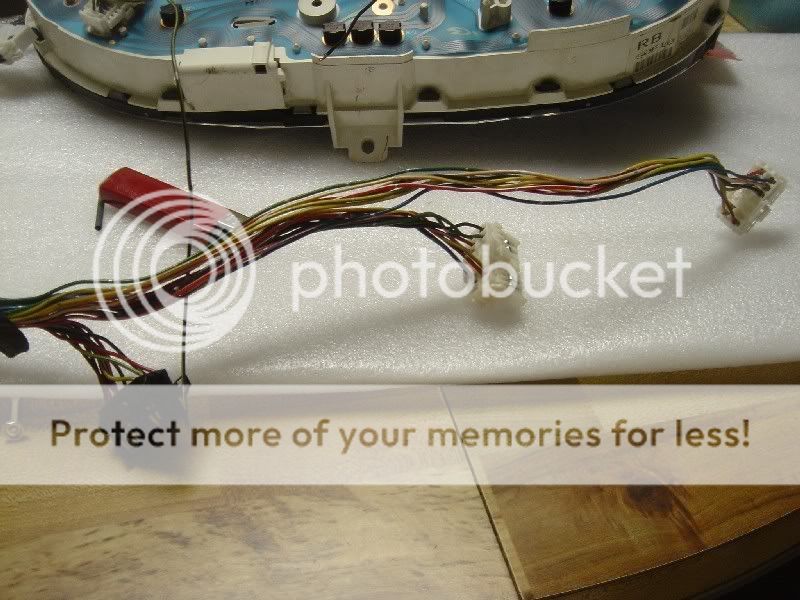

connecting the wires one by one...
more connecting...
finished.. wrapped up...
plugged into the back..

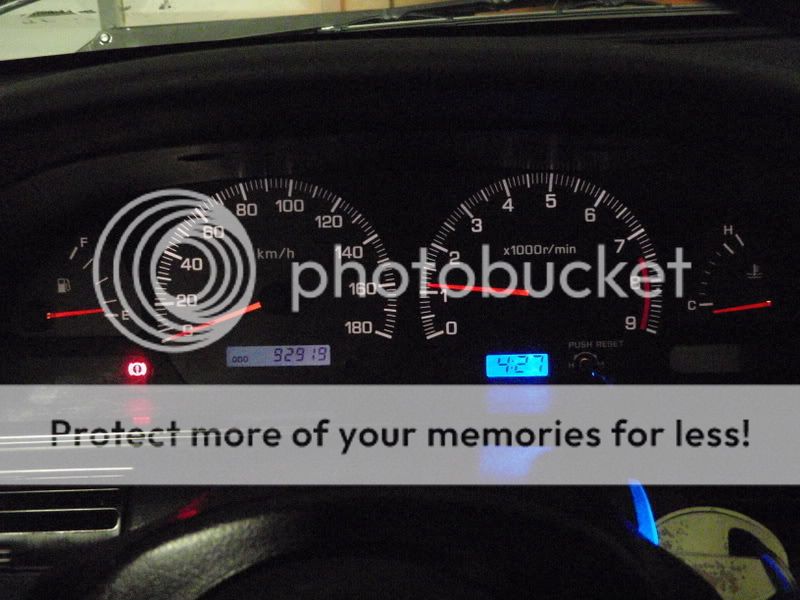

After you finish wiring everything back, this is what it's supposed to look like.
Hope that helps, you just got to dive in and do it.

everything is there for you, there are 30 wires that need to be cut and spliced and iam sure everyone knows how to take their cluster out if you don't then you should not be doing this and iam not doing a writeup on each wire, the diagram there was done by myself and 2 other guys that originally started doing this if i have to do it like iam explaining shit to a 4 year old then you don't need to tackle this because its not easy and will be an expensive mistake if you screwup. hell i think everyone knows how to read so guess what right now this is the only writeup on the internet on how to install this cluster

Why didn't you just repin the harnesses? You wasted so much time/effort cutting and soldering and or taping.
because when i got the cluster the harness was cut so i had to rewire it with the usdm cluster harness also had to change wires so there would be no airbag light on and there is no check engine light on the kouki cluster so i had to use the Overheat catalisor light as my check engine light also had to take off the hicas light, abs light and over drive light

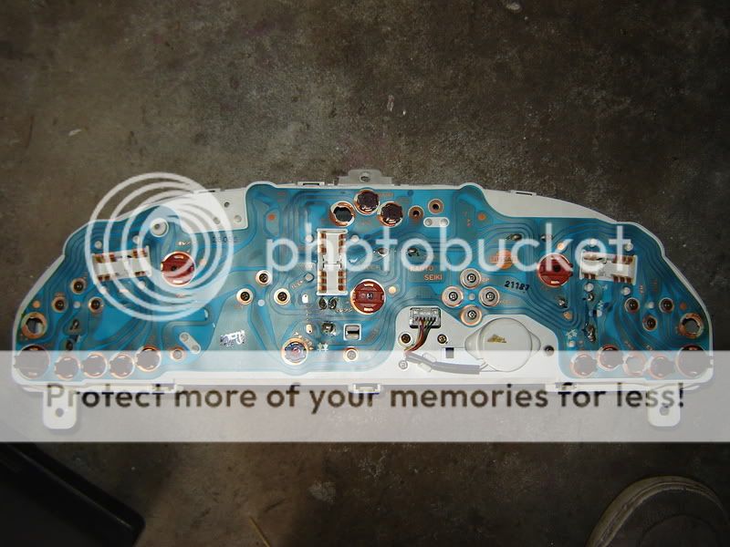

and here is the back of the usdm 240sx cluster
so based on these 2 pictures i call Bull shit

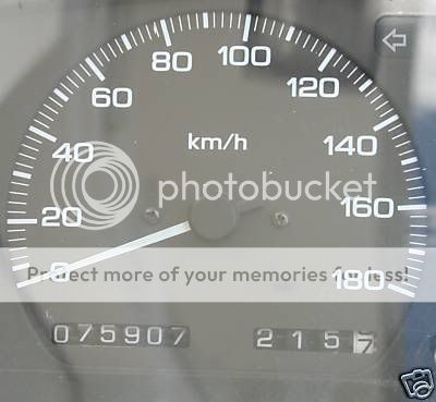

this is the cluster you guys have
note the analog ODO its not digital, do you guys even read or just look at the pretty pictures?
